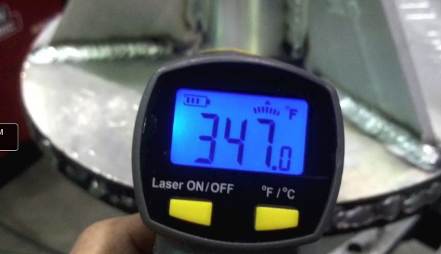

One main tip that I was reminded of on this project is that when you have multiple parts where a flange or plate is welded to one end and there is a risk of distortion, tacking or clamping the plates together where stresses can be offset works great.
I also had to heat these parts up to about 350f with a rosebud tip and let them slow cool to make them come out flat.  That was a lot of welding on one side of a plate and it did want to warp.
