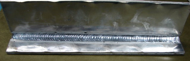

aluminum-tig-welding-diamondplate-tee Tig welding aluminum is just plain cooler than crap! I mean for starters, not that many people are good at it. But when you get good and can stack the weld ripples like dimes, you are the man and everybody wants to be you.

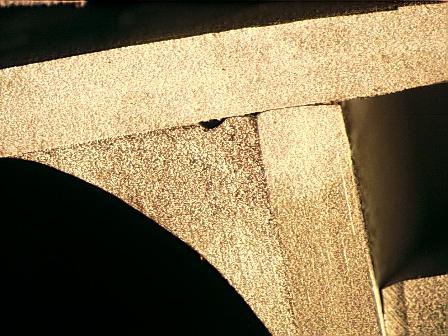

Some people think tig welding aluminum is more difficult than welding any other metal. But I say that once you learn, it is just another metal with its own set of unique requirements, not harder, just different. But it can be harder if you don’t understand the fundamentals of tig welding. Aluminum will not let you get away with much. You can get away with a lot on steel, but those bad habits will bite you in the butt on aluminum. All the textbooks on welding aluminum state that you must wire brush or mechanically clean aluminum before welding. Unless you are operating a not for profit business, It is not practical to wire brush or mechanically clean every joint. If you don’t believe me just look at a wal-mart bike or a tuna tower on a boat sometime, you won’t see any wire brush marks or sanding scratches. That’s because it cost money to clean the weld area and besides that wire brush marks and grinding scratches look like Fido’s ass. Besides, if you are welding new metal, the cleaning action of the alternating current will clean the weld area pretty well. (Unless you require an x-ray quality weld). Let me just say that again in case you didn’t understand. If the aluminum is new and not heavily oxidized or dirty or contaminated in some way, the alternating current arc will clean the puddle adequately to get a sound weld. I am talking about general work here, not aerospace or nuclear code work. Most welds have some amount of internal defects like porosity. The trick is to keep them to an acceptable level.
aluminum-welding-lack-of-fusion
"The Skinny" on Welding Aluminum

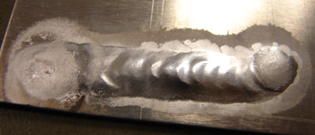

Anyway... here is a shot of an aluminum tig weld made with reverse polarity. Notice the frosty area next to the weld. That is what is known as “cleaning action” and it is a good thing.
But too much of a good thing... is not always a good thing.

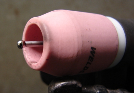

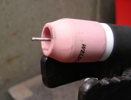

Aluminum-tig-welding-dcep aluminum-tig-electrode-balled-dcep Welding on Reverse polarity heats the electrode up a lot and balls it as you see in the photo above. You have to use a lot bigger electrode than you would on A/C. This makes it impractical. A lot of old timers say you should "Ball" the electrode on Reverse polarity and then swap over to A/C.
I would rather be "kicked in the balls" than to weld with a big ball like that! and getting kicked in the balls hurts. Oh! Aye! a lot!
A better way is just to round the tip of the electrode like you see in the photo below. You will get much better low end starts and more arc stability with a small rounded tip.

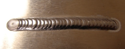

Now compare this to aluminum tig welding on alternating current with the a/c balance set to max cleaning.

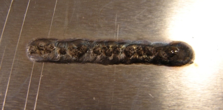

aluminum-tig-welding-balance-0 Below you see aluminum tig welding on DCEN or Direct current electrode negative. You can see how crappy it looks. The oxide skin was not broken down and the weld looks like Fido’s Butt. Tig welding aluminum should never ever look like Fido's butt. aluminum-tig-welding-dcen Now look below at this aluminum tig weld made on alternating current with the a/c balance set to max penetration. Notice that the cleaning action does not extend past the weld much at all. Ahhh...Just right...This is the Shiznit. This is what tig welding aluminum should be like. aluminum-tig-welding-balance-10
