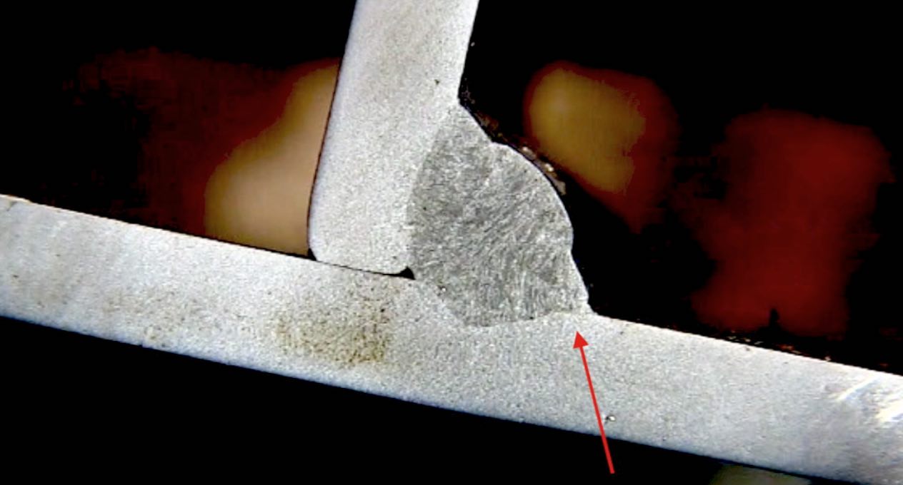

here is the macro etch result at 280ipm
The Lincoln power mig 210mp default setting of 19v and 280 ipm was pretty good.

mig welding at 19 volts and 250ipm
I lowered the wire speed to 250ipm and not much changed but I did notice more small spatter.
here is the macro test from that weld
Not a huge difference in the arc but notice that there is a straight line near the toe of the weld. I think the mill scale is having an effect on penetration as the wire speed is lowered

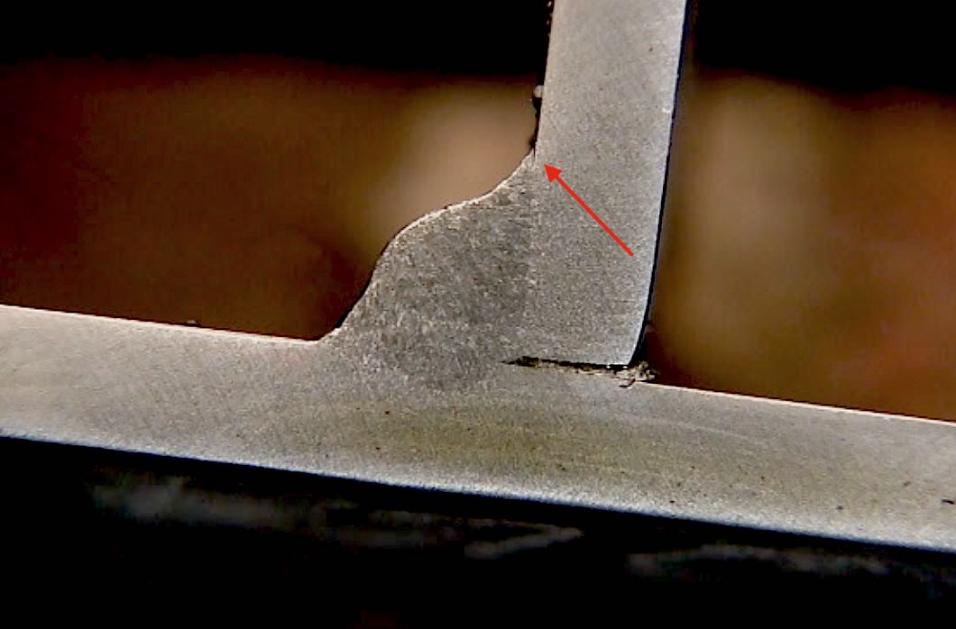

200 ipm
200 inches per minute slowed the travel speed quite a bit.
Since I am not a robot, I think I manually compensated for the lower wire speed by slowing down my travel speed.
Slower travel speed increases heat input and that might explain why at 200ipm, the resulting weld penetration was not that bad.
straight lines are always a red flag.  Mill scale is becoming a factor.
