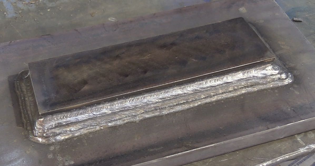

Stick Welding with 3/16" 7018 electrodes
While filming this video , I was thinking about my very first stick welding job.

Stick Welding with 7018 vs 11018 rods
The numbers 70 in 7018 indicate a minimum tensile strength of 70ksi.
But there are stick electrodes that have a higher tensile strength than 100 and so another digit is needed.
So in the case of 11018 electrodes, the first 3 digits indicate tensile strength.
Small alloying elements like chromium, nickel, and molybdenum are added to 11018 to increase the strength but they burn very much like 7018 electrodes.
Both 7018 and 11018 rods are considered low hydrogen electrodes and should be used within a few hours or kept in a rod oven once exposed to air.
Some welding codes are very strict on how long a low hydrogen electrode can be stored on the air before it is no longer considered low hydrogen.
There are even limitations on the number of times a low hydrogen electrode can be reheated to remove hydrogen.
On that first job of mine, they were not too concerned about keeping the rods in a portable rod caddy during the workday, but i went thru a 50 lb can every day sitting on my bucket.
