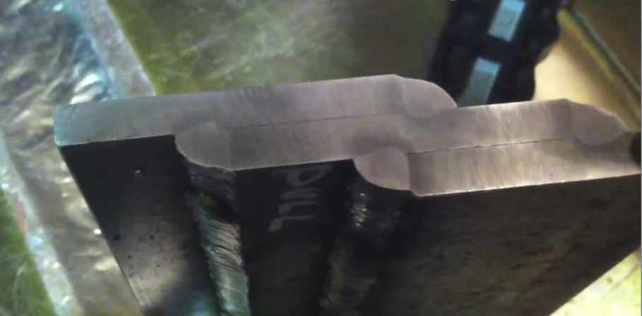

Pushing vs Pulling
Is there a right way and a wrong way?  Is pushing better?  Is pulling better?
Testing gives answers.  Arguing just leads to more arguing.
The video shows it best.
