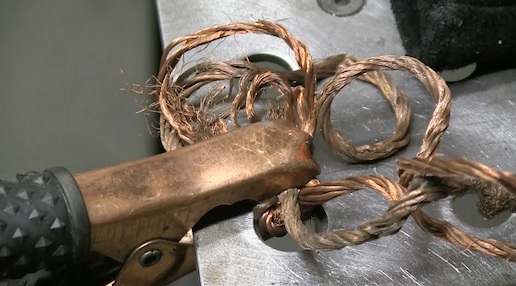

  8. make sure you have a good ground. A good solid ground is more important with mig welding than other types of welding.  If you intermittently lose contact , your welder keeps pumping out wire and thats where you get a stutter, or a false start.  That sputter can make you think your wire speed settings are wrong.
    I use a short piece of bare braided wire from an old tig torch or welding lead and clamp it on a clean surface of the table or better yet, directly to  the part I am welding.
