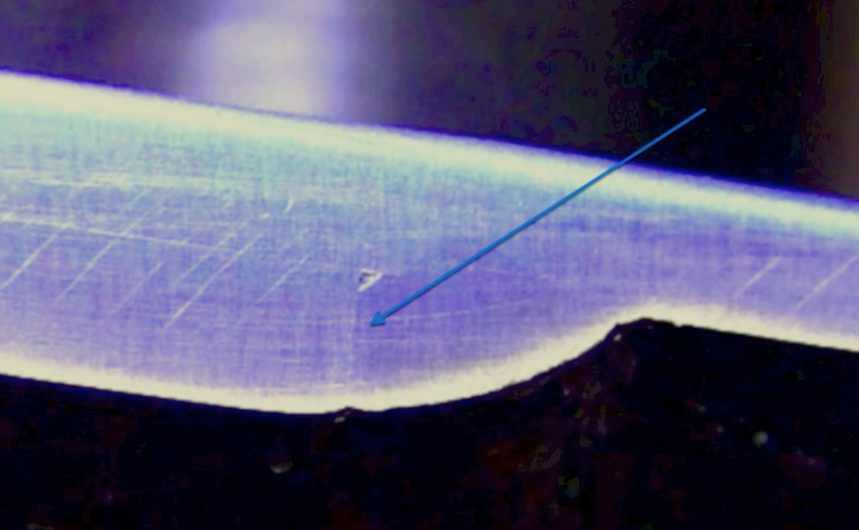

Just to demonstrate that a visually acceptable weld can be a cold weld with plenty of lack of fusion, I used the same settings as I used for the 11 ga (3.2mm) thick cold rolled steel.
I purposefully hung back in the puddle so that the arc would not reach the root.
Just as suspected, the root of the joint had considerable lack of fusion when I tested the weld by cutting, polishing, and etching.

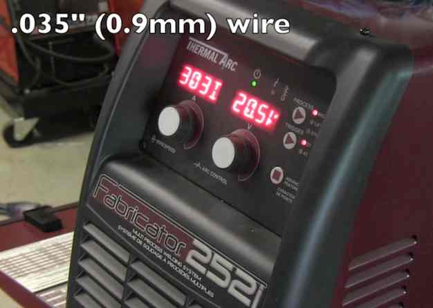

Switching to a heavier machine with .035" (.9mm) wire, I expected better results.
But in fact, the test revealed severe lack of fusion due to the thick mill scale coating.
In fact, the hotter settings yielded a weld worse than the one using small diameter wire and lower amperage.
I suspect cleaning the mill scale would have helped a lot.
But I didn't clean the metal at all because I wanted to show real world conditions welders are up against.
