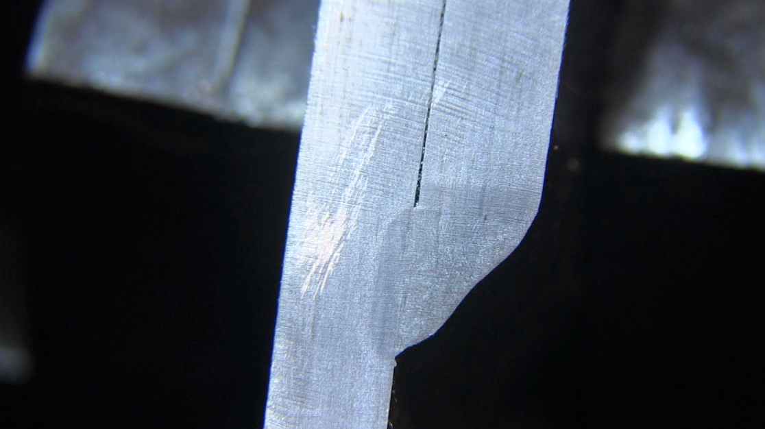

Does cleaning Mill Scale make a real difference on Mig welding downhill?
In part one, I welded a lap joint using hot rolled steel without cleaning the mill scale.  20.5 volts and 303 ipm of .035" er70s6 wire.
The results surprised even me... and I have cut and examined a whole bunch of welds.
I really expected this weld to be a lot better than the one welded using .024" (.6mm) wire.
But instead this weld had serious lack of fusion in the root and extending over half the thickness.
Keeping the settings the same but cleaning off the mill scale resulted in a better weld nugget profile. But still questionable.
I say questionable because their was just no real depth of fusion.
While I am sure there was some fusion going on, the weld looked more like a braze or soldered joint.
You dont want to see straight lines when you cross section and examine a fillet weld.

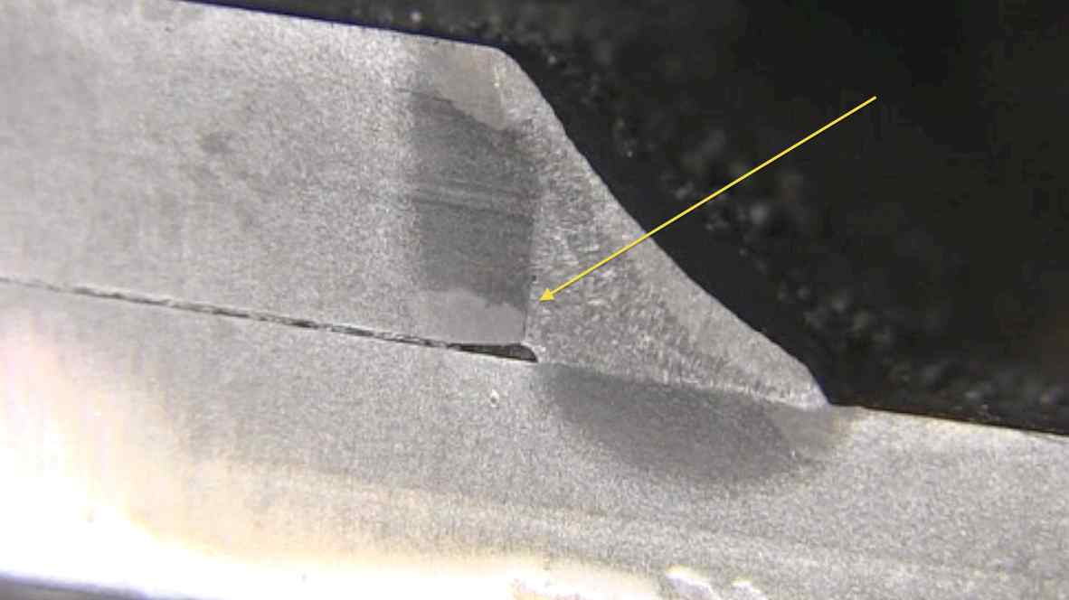

so then I wondered if lower settings and a slower travel speed would help
It might seem odd, but after I saw the results of the 1st lap joint at 20.5 volts compared to one done slower but colder, I couldnt help but wonder if slowing the travel speed just a bit using lower settings would actually improve the penetration.
It did.

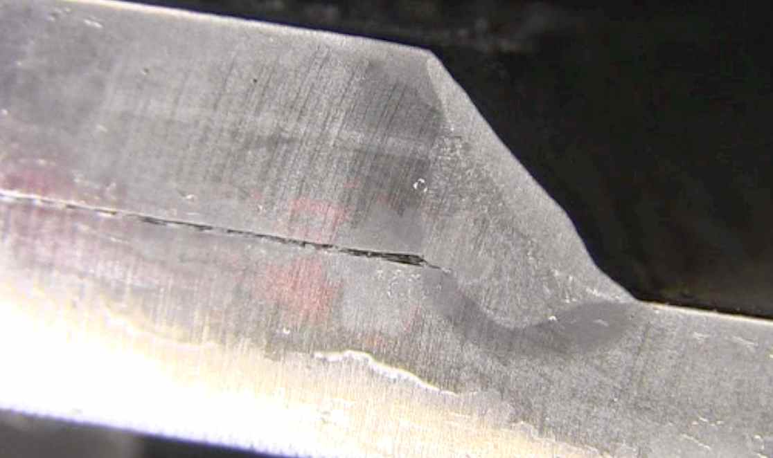

What if I did 2 quick Downhill passes?
The thought occurred to me...
If the puddle is chasing me, and fast travel speed is preventing penetration,  then what if I weld 2 smaller passes?
will that help?
I tried to really point that wire into the root on the first pass.
and after about 30 seconds of cooling time, I came back with the second pass....trying all the while to keep the arc on the leading edge of the puddle.
The results of the 2 pass downhill weld were less than amazing.
there was a pretty distinct fusion line, but a straight line is not something you want to see.  there was very little depth of fusion.
This method has potential, but does not seem robust.
I would like to see some more depth of fusion to feel good about it.

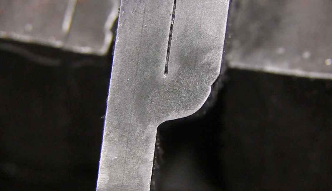

Lets compare some downhill mig welding to uphill
Welding on mill scale again and not cleaning at all.
and Lowering the settings to 18.5 volts and 211 ipm wire speed revealed this...
Thats a nice nugget profile with plenty of depth of fusion.
lets try one more and clean the metal and lower the wire speed
18.5 volts and 190 ipm using .035" wire and on clean metal.
all mill scale removed.
Mig welding Downhill is definitely easier and faster, but...
When penetration is the main thing uphill might be the best choice
