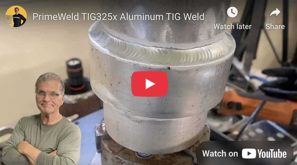

Primeweld TIG325x Videos
I like the digital readout feature on the primeweld tig 325x. It makes setting pulse rates easier.
water cooled package shown below with ck 20 torch
primeweld 325 package with cooler
