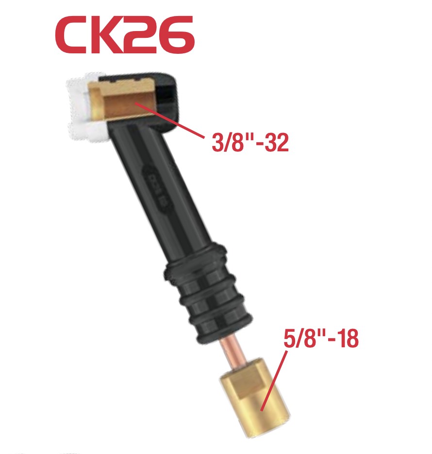

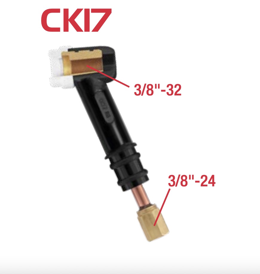

What is the difference in a CK 17 and a CK26 TIG Torch
ck17-torch-body-threads
ck26-torch-body-threads
The main 3 differences in a ck17 and a ck26 are:
  1. overall torch size
  2. amperage capability
  3. a different thread connection to the torch cable.
The image above also shows a different thread where the torch cable connects.  The CK26 has a 5/8"-18 thread while the ck17 has a 3/8"-24 thread connection.
A 26 style tig torch also requires a different dinse adapter due to a larger connection on the other end of the torch cable is a 7/8" x 14RH power cable connection
The Dinse adapter for a ck26 torch is part number SL8-35
The different thread configuration is due the the large torch cable needed for extra amperage capability.
