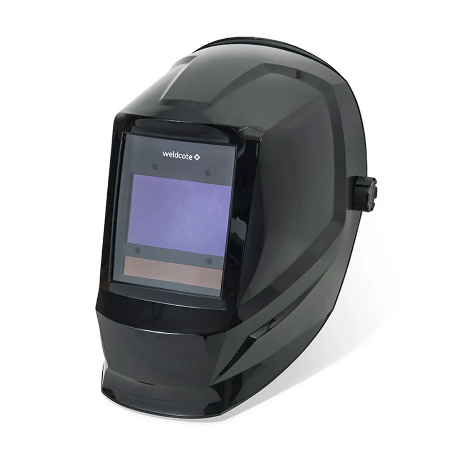

#4 Mig Welding Tip...get a good Auto darkening Helmet
I Know there were only supposed 3 Mig welding tips...But this one is probably as important as any...
  Even moving a quarter inch off track when you nod your helmet down can really screw things up with mig welding. Why? Because Your mig welder does not care about you.
Mig machines just  start laying down metal without concern for your well being or whether or not you are on track. With an Auto Darkening helmet you can see where your wire is pointing before you pull the trigger.
