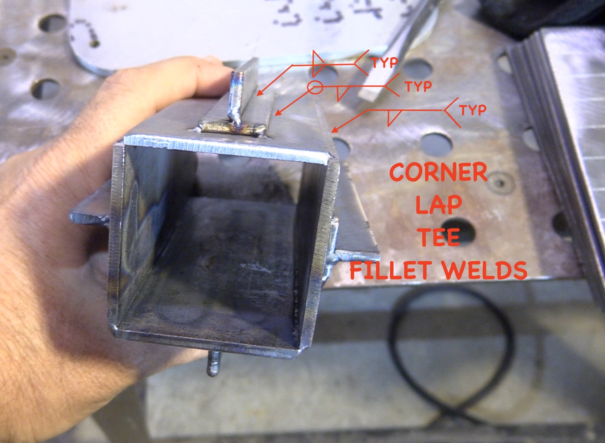

This project includes outside corner joints, lap joints, and tee joints.
And because the metal is 11 ga, and has so many welds in close proximity, one main challenge is that the piece gets really hot and requires some patience and heat control.
So for the outside corner joints, I used a block of aluminum as a heat sink.
there is also some weld sequencing that comes into play...along with making sure an adequate number of tack welds are included.
(I demonstrated how not having enough tacks and weld out of sequence can provide problems)

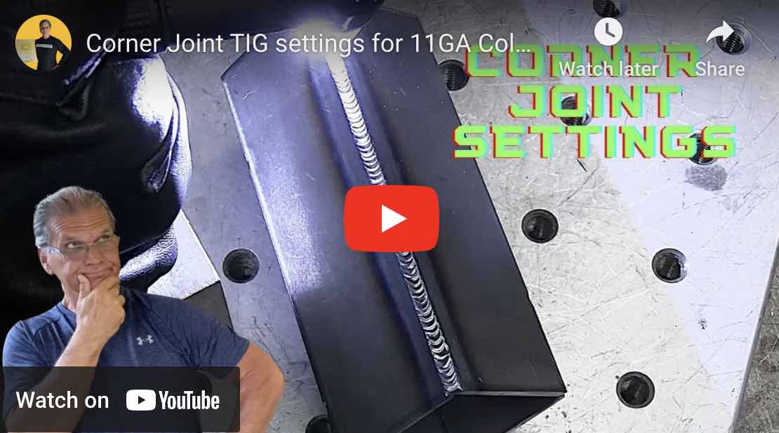

Outside Corner Joint
Watch another video demonstrating outside corner joints
11ga-mild-steel-corner-thumb
The outside corner joint is technically a fillet weld and is one of the most commonly used joints and is used when making tanks, boxes, reservoirs, and many other shapes.
When building something, a press brake can be a better solution than welding but if a press brake is not an option, an outside corner joint can often suffice.
I have several blocks of aluminum I have saved over the years and I used it as backing and chill blocks for the back side of outside corners with sheet metal.
Even though the metal used in this project was 11ga , it still benefited from the use of chill blocks due to the piece being small with so many welds all close to each other.
Lap joint
Lap joints are fillet welds and are very common. patches, doublers, etc are made using lap joints.
At first I was going to simply weld 4 outside corner joints along with 4 tee joints using the same 2" x 6" x 11 ga pieces.
But I decided to get some smaller flat bar at my local ACE hardware store so that I could include lap joints.
All they had was hot rolled so I had to clean it using a Walter Enduro-Flex 2-In-1 Finishing Flap Discs (its abrasive sandwiched in between scotch brite)
Tee Joint
Tee Joints are made using fillet welds too.
gussets, braces, tabs, are all welded using fillet welds.
The challenge on the tee joints on this project is that the back side gets red hot and scales up making the second side of the joint weld like crap.
one way to avoid this would be to use a chill block on the back side of each tee joint so that the back side would not oxidize so much.
I neglected to do that...and so had to use a thin grinding wheel to clean up the back side in order to make it weld decent
