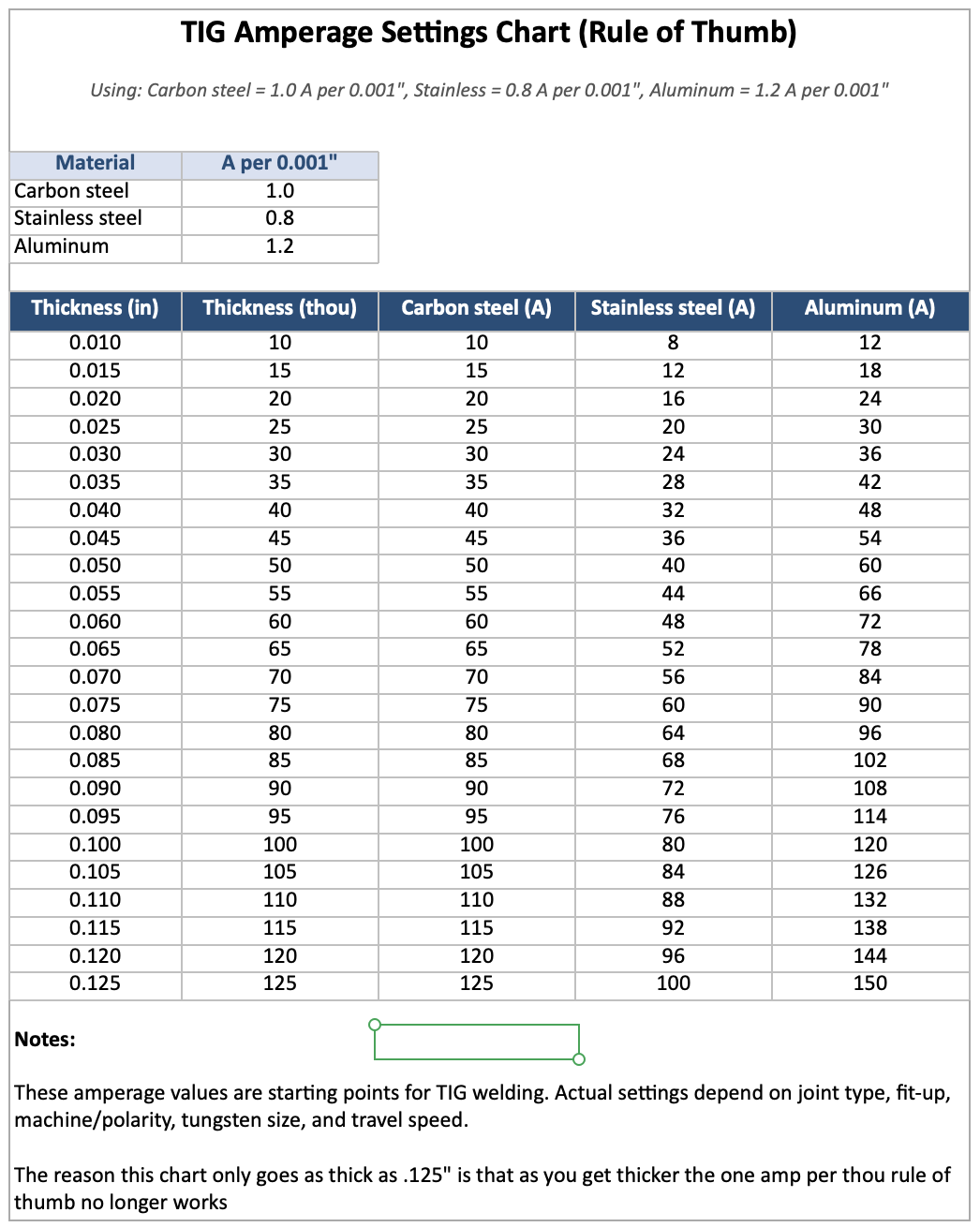

Amperage—pretty straightforward...but there is a simple rule of thumb that holds true up to about .125" thick metal. (3.2mm)...mainly for carbon steel
one amp per one thousandths (thats about 40 amps per 1 mm)
A little more than one amp for aluminum
A little less than one amp for stainless
once you get thicker than .125" the one amp rule starts to drift and not work as well.  (I mean think about it...you don't need 500 amps to tig weld .500" thick steel.)
