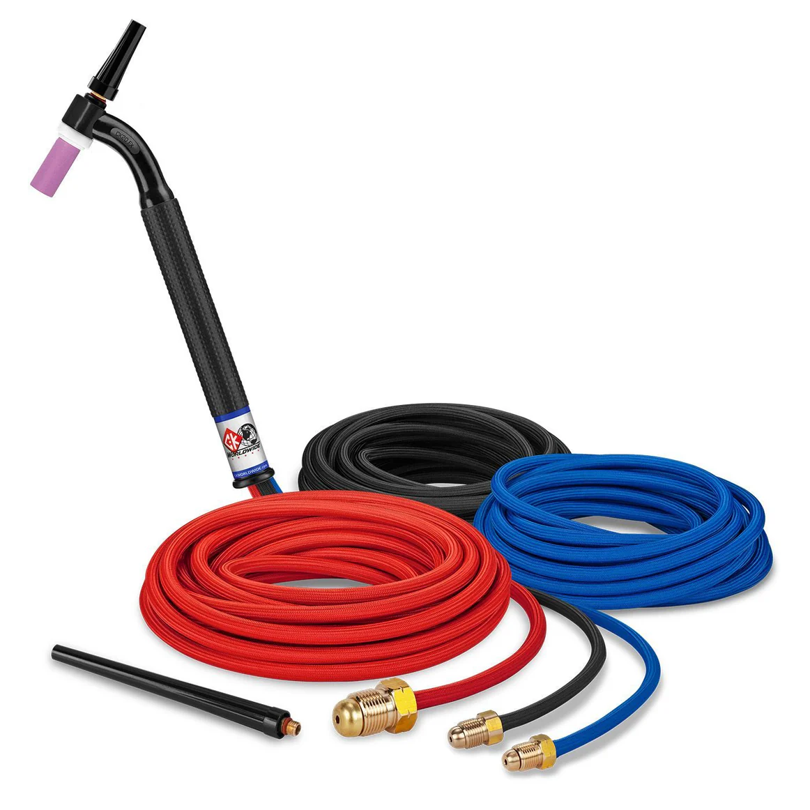

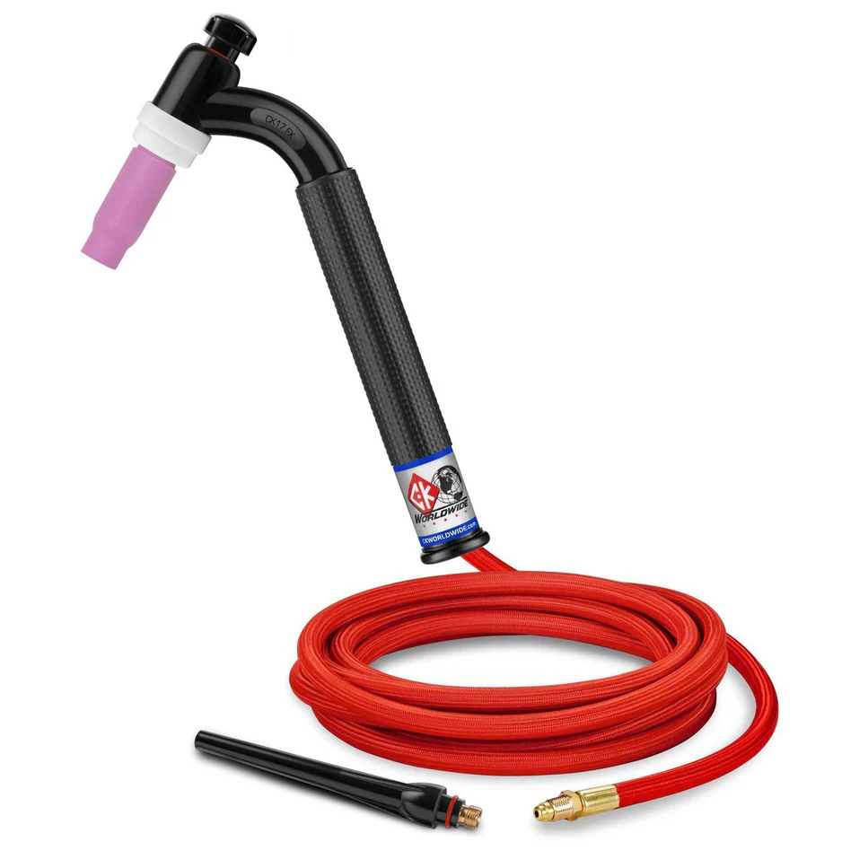

17 TIG torch? If I had to chose only one , It might just be a CK17 with SuperFlex cable
See Videos about 17 TIG torches along with Latest Welding Videos here
What 17 TIG Torch do are you looking for?
We have several different torches with Super Flex cables.. both rigid or flex head

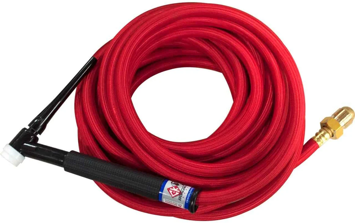

This is my favorite 17 TIG torch.  Its a CK Worldwide CK 17 150 amp with super flex cable
Available in either 12.5ft and 25ft
click any image above for price and reviews
CK17-tig-torch-12ft-flex-
CK17-tig-torch-12ft-flex-with-text
CK17-tig-torch-25ft-flex-with-text-

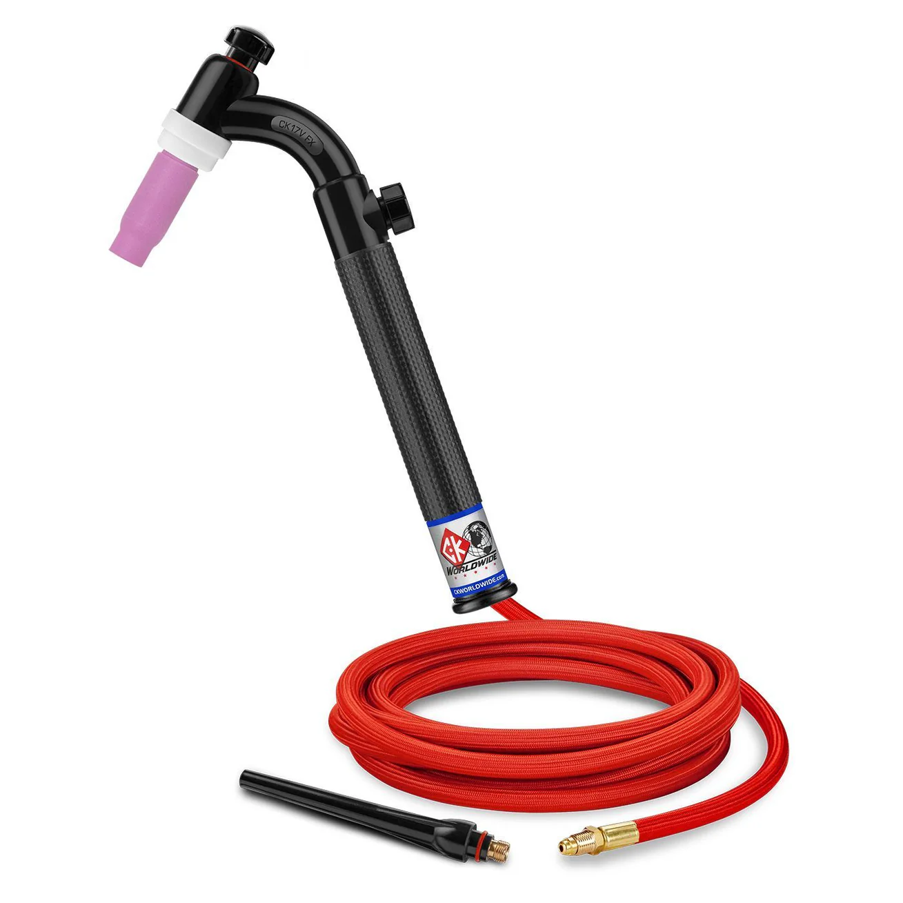

17 Series TIG Torches are also available with a valve .  Click here or image below for prices.
ck-17-series-torch-flex-valve
CK_CK17series-torch-V-12-RSF_FX
When do you need a tig torch with a valve?
  • For the most part, a tig torch with a valve is used for Scratch start using a stick welder. See video here
  • Another reason for a valve is when using Multiprocess welders like the Primeweld MTS200. Which is a  MIG welder that also do stick and DC lift arc tig. see video here
  • Some welding machines are Lift arc TIG only without an internal  solenoid valve. A torch with a valve is needed to turn the argon off when not in use.
  • Another reason you might need a tig torch with a valve  is when your tig welders internal solenoid craps out and you need to get a job out the door.  I knew a fellow who got an unreasonably expensive  quote to replace his solenoid on a his miller syncrowave 250 so he just switched over to a torch with a valve. All he had to do was to connect directly to the flowmeter and control the argon flow at the torch.  Not ideal, in my opinion,  but it does allow  you to keep welding.

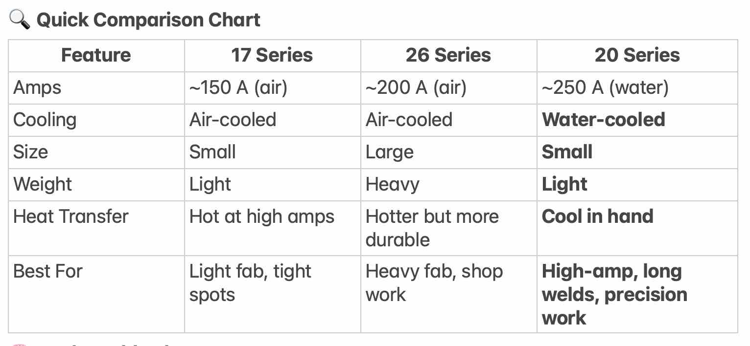

Basic differences in the 20 style water cooled TIG torch and the air cooled 17 and 26 series.
đź’§ 20 Series TIG Torch (e.g., CK20, WP-20, SR-20, WT-20)
  • Amperage Rating: ~250 amps
  • Cooling: Water-cooled
  • Size/Weight: Small and lightweight—smaller than a 17, but higher capacity due to water cooling
  • Comfort: Runs much cooler in your hand, even at high amps
  • Common Uses: Ideal for precision TIG work, production welding, stainless, aluminum, exotic metals, aerospace welding, tool and die, mold repair.
Comparison Chart
17 tig torches, 26, and water cooled 20
tig-torch-chart-17-26-style-tig-torches
CK20-25SF-water-cooled-tig-torch
  • 20 series torches are a favorite in high-end TIG work like aerospace and motorsports because they’re small, powerful, and stay cool.
  • You definitely need a water cooler for a 20 torch, which adds cost and some extra connections—but the comfort and performance are worth it for long sessions or higher-amp work.
  • If you’re welding aluminum with AC or doing any serious TIG on thick material, a 20 series tig torch is a difference maker compared to air cooled torches.
  • An exception is this...For low amperage work under 100 amps a 9 style air cooled torch will work great and feels the same as a water cooled 20 tig torch and you don't need a water cooler with a #9 torch.  But remember... A #9 style air cooled torch will get really hot if you go over 125 amps for extended periods.
