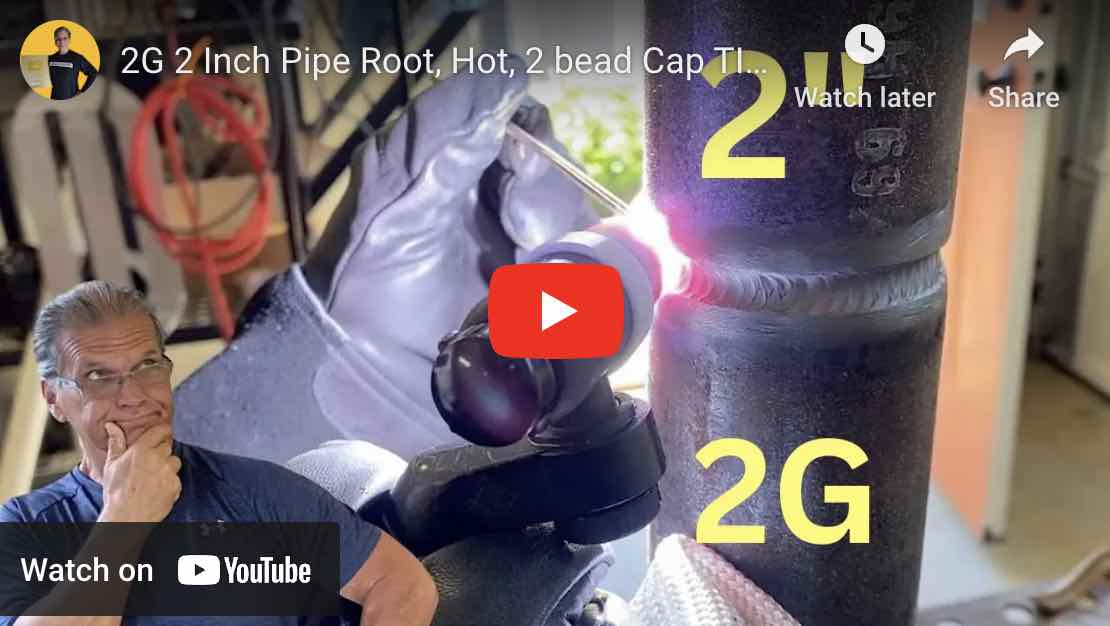

2 inch Pipe Welding 2G position TIG Freehand with TIG Finger
2inch-2g-pipe-welding-test-thumb-freehand-tigfinger-thumb
2 inch Pipe Welding 6G 6010 root, 7018 Cap
My good friend Andrew Cardin doing the welding again for the video above.
This is a 2 inch 6G test where the root pass is done with 3/32" 6010 at 65 -70 amps and the cover pass is welded using a 3/32" 7018 at 80-85 amps
