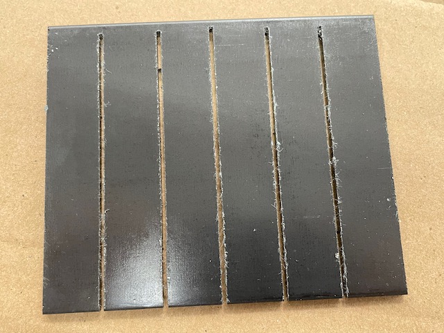

Practice piece with Saw cut gaps
reignite-hope-5-fingers-practice-3g-weld-test-d9
The AWS D9.1 sheet metal welding code includes an uphill 3G open root test on roughly 1/8"  thickness using GMAW-s. (short circuit mig welding).
It is a simple test compared to thicker multiple pass welds but is kind of a tricky test because there is a fairly narrow range of settings that will yield good results.
This single pass uhill mig welding test is used by Reignite Hope ( a non profit that provides welding training for free to people who have lost hope in life).
This test is both a stepping stone and a confidence builder for folks who need a little help to get back on track in life.

I felt like 17 volts was going to work but I just needed to find a good wire speed setting.
So I tried 17 volts and 150 inches per minute for the first weld and while the penetration was ok, the front side was not uniform.
So I bumped up the wire speed to 155 inches per minute to see if that got worse or better.
Things seemed to get worse, not better but that was exactly what I needed to see.
...so I reduced wire speed to 144 inches per minute and that seemed to help with the excess reinforcement on the front.
