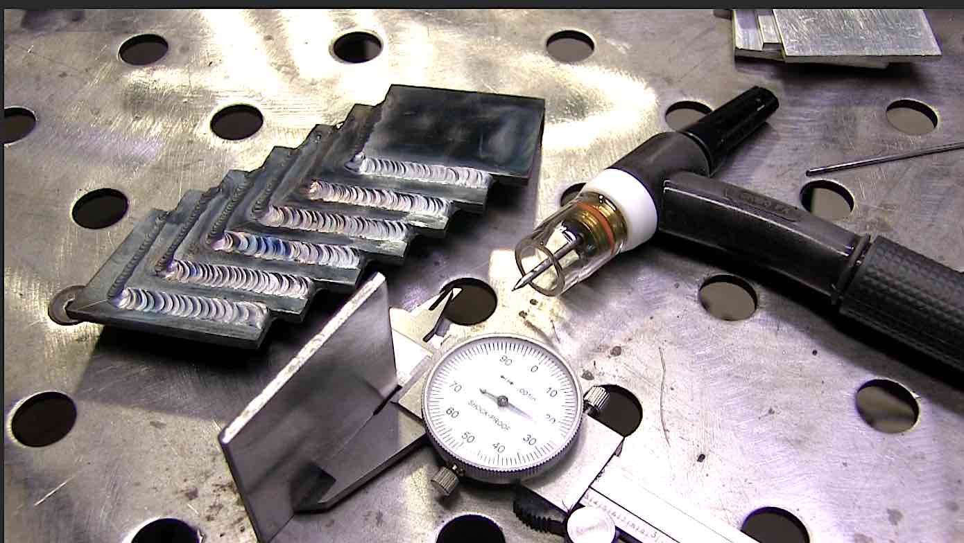

I had some 2"x2" drops of cold rolled flat bar so I decided to get some tig welding practice on some lap joints.
The material was .125" (3.2mm) cold rolled steel.
I set the amperage to 120 and was pretty close to full pedal at times and topped out at 117 amps.
That just goes to show you the one amp per one thousandths of thickness is a pretty good rule of thumb for .125" and under.
click here to Check out  the #8 furick cup at weldmonger.com
120 amps with foot pedal amperage control (117 amps max reached)
3/32" (2.4mm) 2% lanth electrode
1/16" (1.6mm) er70s-6 filler rod
 I started out with a #6 gas lens, then switched to a #7 gas lens
using a stubby gas lens kit for the air cooled #17 CK torch
The #8 furick cup worked the best.
I used around 20cfh of argon with the #8 furick cup and was able to extend the electrode around 1/2" with no shielding problems.
I dont always extend the electrode that far but it makes filming easier.

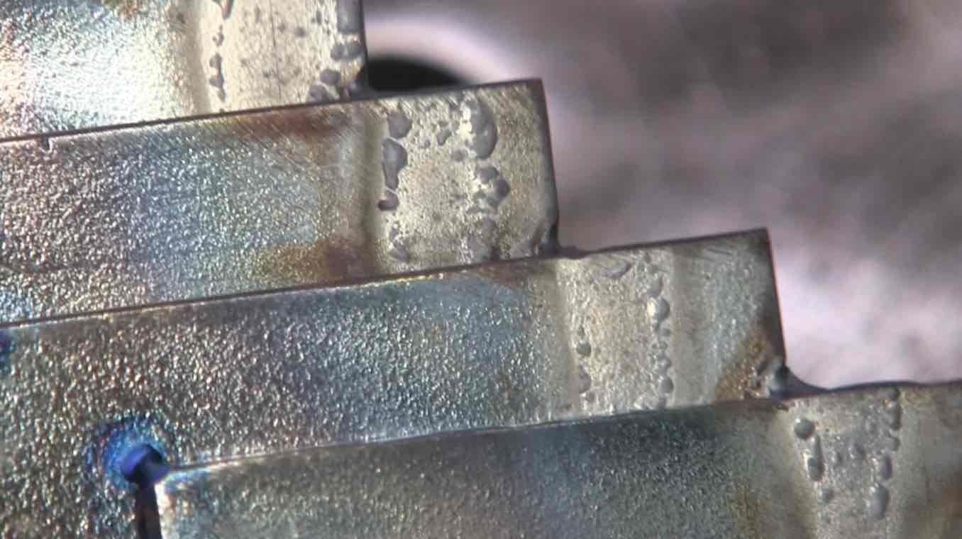

Welding over severe oxidation
When you weld one side of something that is .125" or thinner, the back side will get oxidized unless you have some chill backing or argon shielding on the back side.
Welding over flakes of oxidation is no fun and usually winds up looking bad...or at least not as good as the weld done first.
So if you can clean it down to bright metal with some type of disc, abrasive, wire brush, or carbide burr, that removes the oxide layer completely, the metal will flow better and the weld usually looks a lot better.
