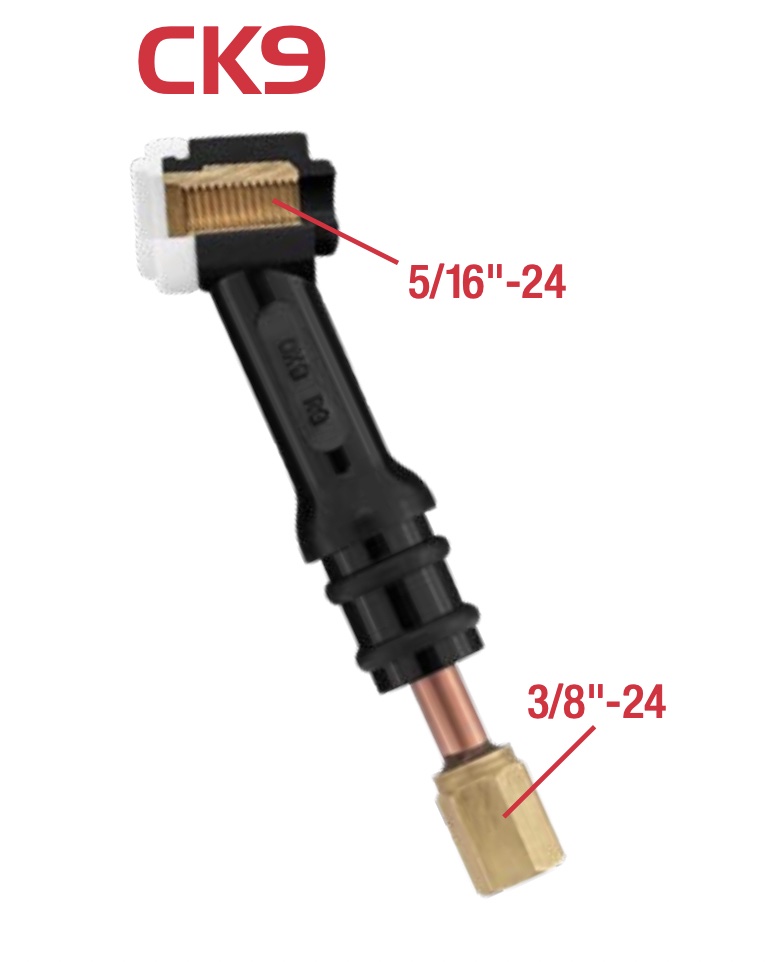

ck-9-tig-torch-threads
ck17-torch-body-threads
You might notice from the 2 pics above that the threads at the bottom of the torch body are the same.
That's because a 9 tig torch and a 17 tig torch both use the same torch cable.
So if you already have a 17 torch and want to try a #9 tig torch, all you need is the torch body.
Did you know you can swap back and forth from a 9 tig torch to a 17 tig torch by just switch the torch body??
This is actually a hack no one talks about much.
Swapping a torch body only takes a minute or so.
