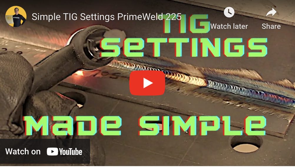

AC  and DC TIG Welding Settings
primeweld 225 tig with stuff
The problem with most other really affordable tig welders is usually a really cheap foot pedal and TIG torch.  Primeweld went to extra expense to include a genuine CK17 torch with superflex hose along with a very smooth SSC style foot pedal.
A high quality CK dinse adapter is also included so that you can easily swap out a tig torch or cable when the time comes.
Primeweld also has a responsive primeweld equipment users group on facebook and also has demonstrated great customer support
Watch some more primeweld videos and you will see what I mean.

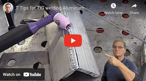

7 Tips for AC TIG Welding Aluminum
tips-aluminum-email
the video above demonstrates 7 great tips for AC TIG welding of aluminum
