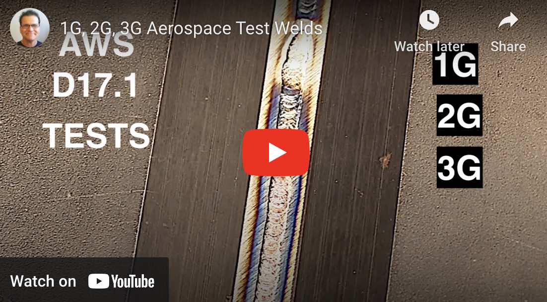

Sometimes other positions are used like 2g and 3g
1g2g3g-d17-practice-thumb
Titanium Aerospace tig welding test
1g-titanium-yt-thumb
