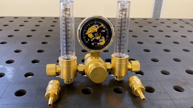

An Argon Regulator Flow meter combines a regulator with a flow meter.
What is a dual flow meter and why use a dual flowmeter?
A dual flow meter provides an additional flow meter so that you can purge the penetration side of stainless, nickel, titanium, and other metals that can get compromised by the atmosphere when molten or even red hot.
One flow meter is used for the TIG torch...
the other can be used for an auxillary purge line.
Weldmonger dual flow meters come with 2 barbed fittings to allow easy use connections of either a standard inert gas hose fitting, or a bare purge hose that can be had from any big box or hardware store.
