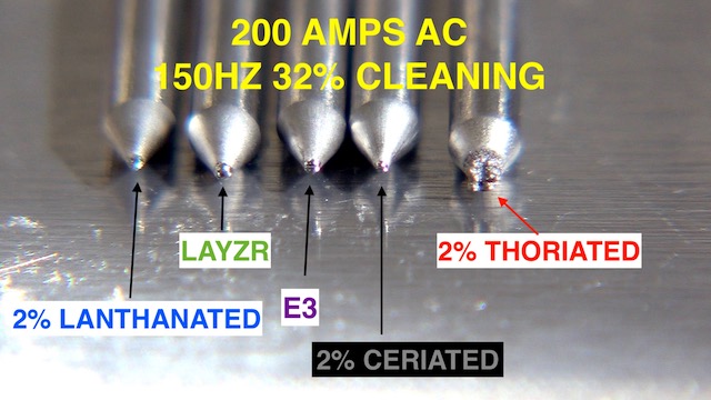

Fortunately, there are a few types of tungsten that work well for all metals and on both AC and DC.
 E3, LayZr, 2% ceriated, and 2% lanthanated are all good all around tungsten that work well on both DC and AC.
My personal preference for an all around best tungsten is 2% lanthanated.
I use it for everything.
But that is just me because I bounce around from aluminum, to carbon, to stainless, to titanium.
Here is my 2 cents on the 4 best all around tungsten electrodes
2% ceriated - if you weld mostly carbon steel, chromoly, or stainless and only occasionally weld aluminum, then 2% ceriated might be a good choice because ceriated maintains a sharp point well on DC.
E3 and LayZr - These both seem to perform identically.  Good low amp arc starts and low tip erosion on aluminum at medium range amperage
2% lanthanated - Good low amp arc starts on both DC and AC and high amperage range on AC. Best all around tungsten in my opinion
