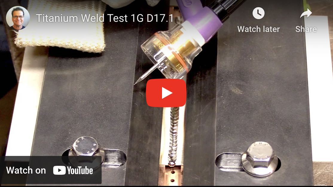

Check out this video on TIG welding a 1G butt joint on Titanium
