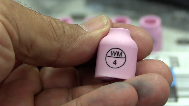

#4 gas lens cup
#4 gas lens cup wm
A great thing about a number four cup is it only requires 8 to 12 cfh of argon so if you want to do some flash tacking on sheet metal or you want to save some gas on a weekend when you're about to run out.

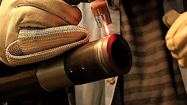

a number six is a great all around cup for aluminum and is also handy for walking the cup for a pipe root pass or for fillet welds on round parts.
You need different size cups for walking the cup for different Groove angles and different fillet welds but a number six is great for a single pass filet weld walking the cup like this it's it's also a great all-around cup for aluminum and one reason is that you can run just a little bit more flow rate and have a little bit longer stick out for getting in tight spots and seeing the tip of that electrode
