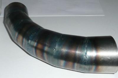

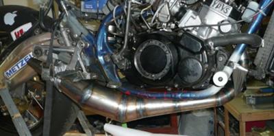

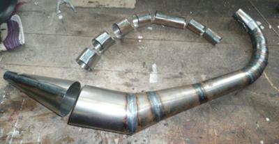

Some 6 month ago I got myself a cheap 180A TIG welder and started a bit of practicing.
For the second project I chose to build some pipes for my RZ350.
Material 0.75 mm mild steel, 1.6 mm tungsten electrode, 7 l/min Argon, 0.7 Hz pulsed between 63 and 50 A. Mostly welded without additional material.
I'm not done yet but that wont be the last pipes I did ;-)
