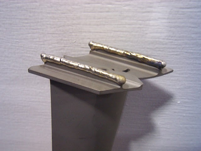

Edge welds and joints are not seen as much as the common corner, lap, butt, and tee joints.
But in the aerospace repair world, edge welds and build up is very  common.
like these air seals on base of this nickel alloy vane where 2 or 3 beads are welded to a seal that is only about .025” or .030” thick…then they are ground on a machine to original thickness and height as part of the repair overhaul process.
real world application for edge welds
