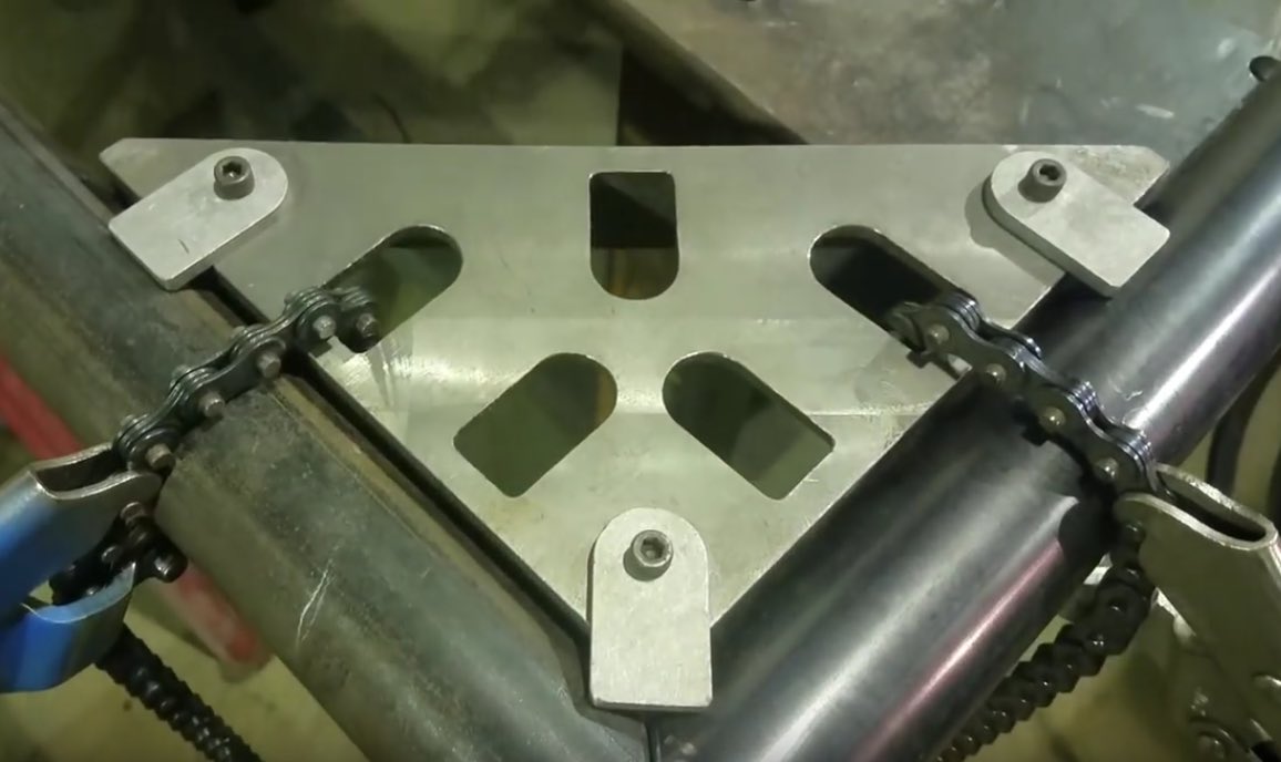

In this video, JD is fabricating a gate using a Flange wizard miter marking tool, a 6" grinder, a Ridgid pipe vise, jack stands, and weld-on hinges. (if youre interested you can learn more about these tools at my weldingtipsandtricks amazon page) and if you buy something, it helps me a bit and doesnt cost you a dime more.
After locking down the tubing in a ridgid tripod chain vise, JD uses the flange wizard marking tool to mark the 45 degree miter cuts.
There are several ways to make these cuts...chop saw, bandsaw, portaband.   But once that first miter is cut, its important to not only have the tubing level, but to make sure it is clocked correctly before the other end is marked and cut.
The flange wizard marking tool is a convenient way to mark angle cuts on all kinds of different shapes like round tubing, wide flange, square tubing etc.
Once he has it marked, JD uses a 6" Metabo grinder with a cutting disc to make the miter cuts.
If you have ever used a 6" Metabo grinder before, you know why JD relies heavily on this tool for cutting. (Sometimes, its quicker than a plasma cutter or cutting torch when you consider cleanup time and prep for welding.)

But for this gate project, JD is using .025" (.6 mm) hard wire and c25 (75argon/25 co2) shielding gas.
The wall thickness on the tubing is only around .125" (3.2mm) so the .025" hard wire was a good choice.
