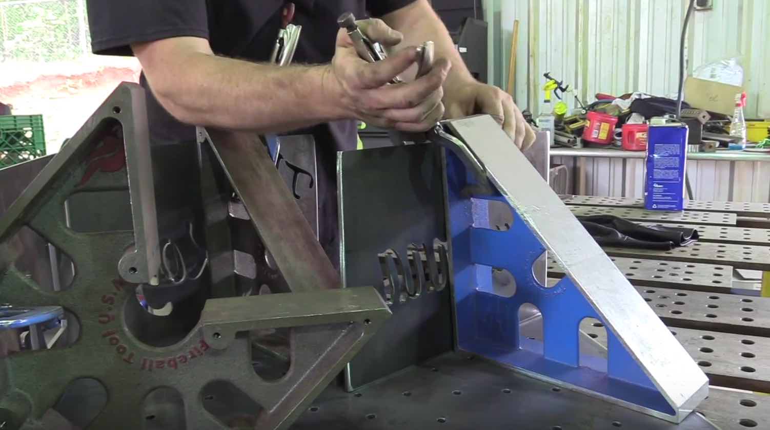

Fireball tools
Last year at Fabtech, JD bought some Fireball tool Squares....line up blocks.
These fireball tool squares worked great for lining up the outside corner joints for the firepit build.
Since they are so wide, they stand up on their own and are easy to clamp to.
Perfect way to line up those outside corners for a tack weld.
