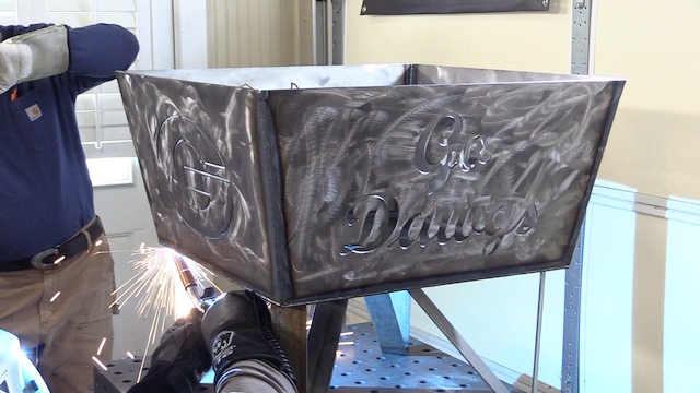

Part 2 MIG Welding the Rest of the Fire Pit with the PrimeWeld MTS200
After TIG welding 4 corner joints using a torch switch on the primeweld tig225x, I decided to weld the remainder of the corner joints with the primeweld MTS200 mig tig stick welder.
The primeweld MTS200 is a mig, tig, stick welder that comes with a CK air cooled tig torch for doing lift arc tig, and a stick stinger for those outside jobs.
primeweldmts200-package
Settings for the 11ga outside corners
I have welded this same joint settings as low as 18.1 volts and 150 inches per minute with good results but travel speed is pretty slow using that setting.
 Mig settings for a task like this can be very forgiving and lots of different settings would work just fine.
If I wanted to get the fire pit welded a lot faster,  I could easily bump  up the wire speed  to 200 inches per minute or even higher using .035” ER70S-6 wire.
I decided to weld it nice and slow.
Once all the corner joints were welded, the only thing left was to tack and weld the legs.
There are some vent holes cut in the bottom plate that serve as guide marks for the legs and eyeballing the legs was easy.
But just to make sure all the legs touched without teetering, I only made one tack weld on each on the inside area so that I could make any adjustments easily after flipping it over.
The primeweld welding table is a really flat surface and the fire pit didn’t teeter a bit so I went ahead and made the final tack welds in place before flipping it over and welding the legs out.
