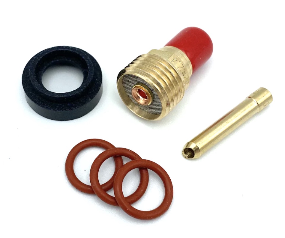

A gas lens is a simple add-on for your TIG torch that can drastically improve weld quality—especially when welding stainless steel, chromoly, or nickel alloys.
In this article, we’ll explain what a gas lens is, how it works, and why it’s one of the best upgrades you can make to your TIG setup.
Gas lens or Collet Body?  it's actually both...a gas lens collet body.
A gas lens collet body has a mesh screen insert that fits inside. It diffuses the argon shielding gas into a smoother, more laminar flow pattern as it exits the end of the tig cup. This results in better coverage and less turbulence.

  1. Remove your standard collet body and replace it with a gas lens collet body.
  2. Use the correct gas lens for your torch model and tungsten size.
  3. Choose a compatible cup—often a larger diameter cup (#8 to #12) to take full advantage of the laminar flow.
