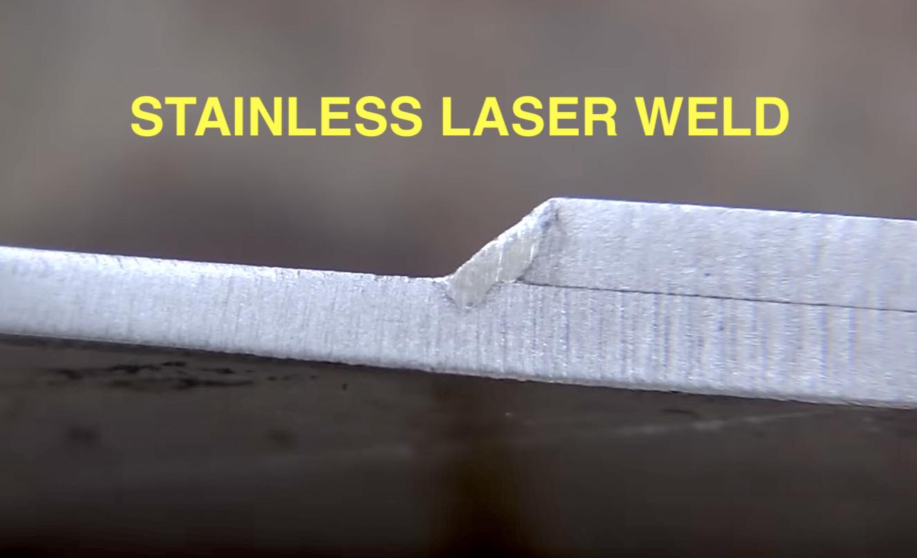

I like to do macro tests on welds to check for penetration so I took the welds back to my shop and tested them
Cut and Etch results
STAINLESS-LASER-MACRO
Aluminum laser weld vs TIG
SIDE-BY-SIDE-LASER-V-TIG-ALUMINUM
The stainless steel lap joint sample showed adequate penetration.
The weld just barely hit the root but that is pretty normal for .080" stainless when your goal is to not penetrate all the way thru.
