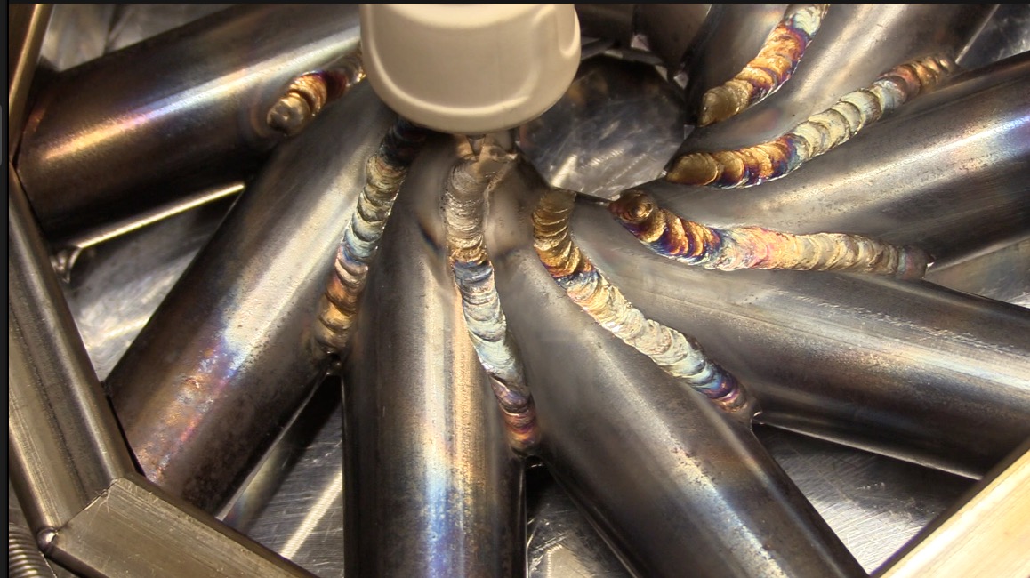

Hastelloy C-276 for TIG welding carbon steel?
Why hastelloy c-276?
Because I have about 10 lbs of .031" hast c276 wire and dont know what to do with it.

The chemical composition of Hastelloy C-276 is...
hastelloy c filler wire
Element    Content (%)
Molybdenum, Mo    15-17
Chromium, Cr    14.5 - 16.5
Iron, Fe    4-7
Tungsten, W    3-4.5
Cobalt, Co    2.5 max
Manganese, Mn    1 max
Silicon, Si    1 max
Vanadium, V    0.35 min
Carbon, C    0.08 max
Phosphorus, P    0.04 max
Sulfur, S    0.03 max
Nickel, Ni    Remainder...approximately 58% nickel.
Applications for Hastelloy C-276 filler rod
Hastelloy C276 is a nickel-chromium-molybdenum filler metal developed for MIG and TIG welding of Hastelloy C and Hastelloy C-276 to themselves, to stainless steel or to other nickel base alloys.
It is also a very good filler metal for welding dissimilar metals like low alloy steels to stainless steels, or for an overlay buttering filler metal.
Hastelloy C276 has excellent resistance to pitting, stress-corrosion cracking and oxidizing atmospheres up to 1900 F.
Hastelloy C276 filler metal is frequently used for cladding carbon steel to improve corrosion and pitting resistance  for  the chemical and petroleum industries.
Hastelloy C276 has excellent resistance to a wide range of chemicals including the corrosive effects of wet chlorine gas.
Other uses include hot contaminated mineral acids, solvents, and solutions(organic and inorganicseawater and brine solutions.
In short, hastelloy c276 filler metal is very useful.
Is it a good choice for welding carbon steel to carbon steel?
probably not...mostly just because of the cost.
at over $50 per pound, it doesnt make any sense to use it on plain carbon steel ...but it sure looks nice.
