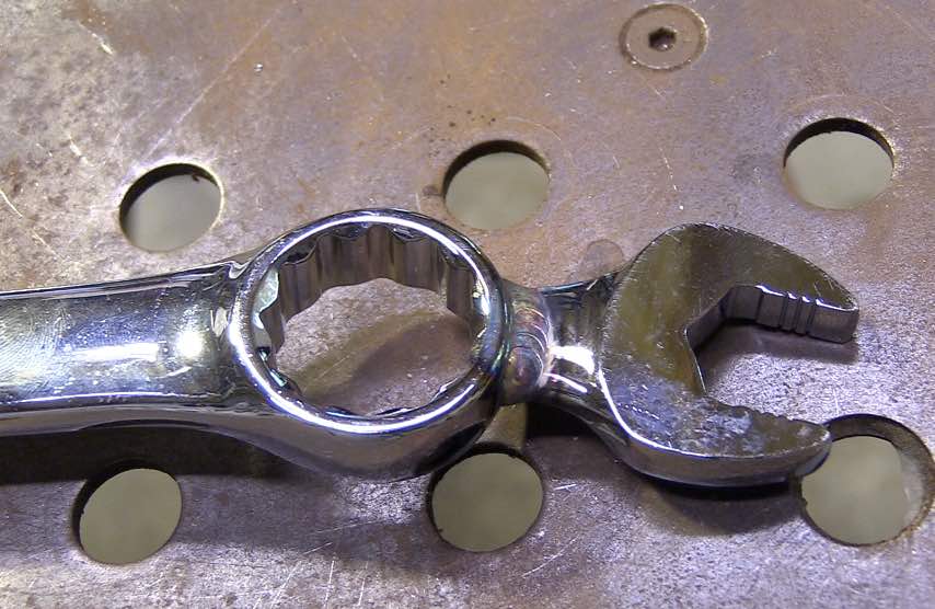

I was tired of always looking for my big adjustable wrench So I decided I would get some cheap open wrenches and weld them together in a way that everything I need will always be hanging on the cylinder.
for the most part, the large nut that you used to attach a regulator to the cylinder is 1-1/8” and the smaller shielding gas fitting is 11/16”  so I got some wrenches on sale that I don’t mind cutting up and welding.

So the wrenches I got for this video are made in Taiwan and say chrome vanadium steel on them.
What is chrome vanadium steel?
Chrome Vanadium steel is an alloy made up  of iron, carbon, chromium and vanadium
Chromium and vanadium both make the steel more hardenable. Chromium also helps with corrosion resistance.
What filler rod should you use to weld chrome vanadium steel?
It really depends on the application and how the part being welded needs to perform in service.
In this case, I know its a simple wrench that will not be under a whole lot of load.  It will strictly be used for loosening and tightening brass fittings on my flowmeters.
So I could absolutely weld it with er70s2 or er70s6 as long as I am careful to avoid crater cracks by tapering amperage.
I could use hastelloy W and since I have welded many wrenches like this with hastelloy W, that would be a great choice.
However, even tho  I was lucky enough to score a bunch of hastelloy W filler rod at scrap prices, I know that it is not affordable for most people (its around 100 bucks a pound now)
So that leaves me with er309.  Its pretty cheap and has usually works very well for welding chrome vanadium steels.  (Provided hardness match and heat treatability are not required )
309 filler rod is designed to weld carbon steel to stainless steel.
And because of that it contains more chromium and nickel than 308L stainless rod to allow for dilution that takes place during welding.
The high chromium and nickel content also make it a great choice for welding chrome vanadium steels because 309 filler won’t Harden or get brittle from mixing with carbon.
Er70 filler rods on the other hand can pick up carbon and Harden.
Always keep some 309 filler rod in the shop…not only for welding chromium vanadium steel but for dissimilar metal combinations where you dont know that exact composition of the steel. (Disclaimer: For critical applications, you should always know the steel)
