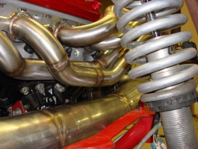

Hi Jody
Take a look at the welds on this SS header.
They are amazing!
The flanges are about 3/8 thick and the tubing is
more than likely 16ga.
It’s all more than likely 304, it may be 321 but I drought it.
How is this guy getting a nice bead that wide?
I have tiged SS from time to time using a sharp
tungsten 2% thorade use 304L filler 1/6 and 3/32
on 16ga SS tubing with pure argon.
How is this guy getting his bead to flow and not burn up
his work?
There is a filler rod called 304LSI that according to the filler rod company flows better that the 304L.
Never try it.
If I put enough heat in my work to get a bead like this I would need a cup the size of a coke can to keep it
for turning my work black.
Is he using a sharp tungsten?
Thanks C
Chris
Reply from jody,
Chris, I deal with the same thing all the time. If I can , I put chill blocks near the weld to draw the heat out and make the weld have some color.
I have an idea on how to do it using aluminum foil and I think I will make a quick video on it if it works.
What I am thinking about is to fold heavy duty aluminum foil into narrow strips about 1/2 inch wide and then tightly wrap several layers about 3/8 inch on each side of the weld and then use some high temp tape to hold it on.
I think it will work..and if it does, I will do a video showing how.
thanks, and sorry this took me so long to answer,
jody
