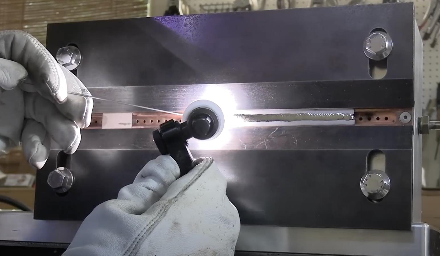

The short answer is you TIG Weld Titanium using DCEN
TIG welding Titanium is not hard.  But you absolutely must avoid the 3 biggest mistakes
TIG welding is by far the most common way to weld titanium so this page is dedicated to tig welding titanium.
How do you weld Titanium and What are the 3 biggest mistakes for TIG welding Titanium?
  1. Not cleaning titanium properly
  2. Not shielding properly
  3. Accidentally not using titanium filler metal. This is the worst mistake

Titanium is known as a "Reactive metal" which means it reacts with oxygen, nitrogen, hydrogen, and other elements in the atmosphere to form unstable and undesirable  compounds that are often brittle.
The goal in TIG welding titanium is to keep all areas shielded with argon and if you do that correctly, you will have minimal discoloration in the weld and heat affected zone (HAZ).
Example of a common aerospace titanium weld test
Titanium loves argon so larger TIG cups like the Furick BBW along with a way to purge the back side with argon are 2 main things needed in order to get acceptable titanium welds.
  • clean with acetone before doing anything else to remove any oil or debris
  • brand new titanium might only need an acetone wipe and no more than that. Fine stainless wire cup brushes on a low rpm grinder work well for removing oxide layer
  • deburr any sheared edge or any rough edge before welding using either a deburr tool, dedicated clean file
  • welding a test strip to verify argon shielding before welding the actual titanium part can save headaches
  • chill bars can be very helpful but are not always practical
  • large cups like the furick MK14 , BBW, or Cippy provide a much larger argon shielding envelope and also help with keeping the hot tip of the filler rod in the argon shield.
  • Strive for silver color, even if this requires stopping frequently
  • check purge gas with a gas purge monitor before welding purged parts
  • keep work area free from other filler metals. Accidentally picking up a stainless tig rod and using it for titanium can scrap a part quickly
  • some titanium parts are best welded inside an argon chamber
