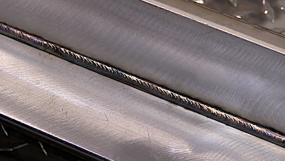

TRAVEL SPEED
travel speed stainless outside corner fupa12
Travel speed is an often overlooked factor in the way it affects stainless steel.
300 series stainless like 304L can lose stainless properties if the metal is kept at too high a temperature for too long.
Travel speed has a great affect on that so a great tip for anyone learning how to weld stainless steel is to pay attention to travel speed.
...and not only Travel speed but getting the puddle started quickly to prevent heat from building up.
Once heat builds from a slow start, it can be hard to outrun it.

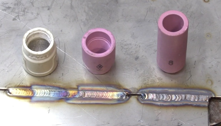

GAS SHIELDING
gas lens vs standard collet body stainless lap
Stainless steel loves Argon.
So using as large a cup as practical can really help you get a better weld.
Gas lens cups help...But specialty cups like the Furick jazzy 10 and Furick 12 work even better because of the added diffuser screens.
When a stainless puddle gets oxidized, it does not flow easily and requires more amperage to flow. Proper shielding prevents oxides from entering the puddle.

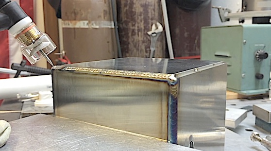

CHILL BARS
stainless corner weld chill bars 8 gas lens cup
Chill bars are not always possible to use but when they are, I recommend it.
chill bars not only prevent distortion but pull heat out of the part so that a smaller cup can give the same results as a larger one.
