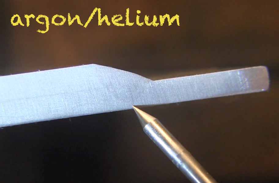

And while its perfectly capable of welding 11 ga aluminum without adding helium, I limited amperage to 100 amps just to show the difference between pure argon, and a argon/helium mix.

The quickest, cheapest, and easiest way to test an aluminum lap joint like this is the Macro etch test.
Macro just means low magnification ( like around 10x) so a fine polish is not necessary just to reveal the weld nugget profile.
Fortunately, there are several household products that will do the job for etching the weld area.
Etching is sort of a controlled corrosion.
Etching aluminum using an alkaline solution removes a surface layer of smeared metal and allows a person to distinguish between weld metal and base material.
I used Easy Off oven cleaner for this video.  I just sprayed a small amount on a Qtip and swabbed the weld for a few minutes and then wiped clean with a wet paper towel.

The lap joint welded at 100 amps using pure argon didnt penetrate near as much as the lap joint welded at 100 amps using argon/helium mix.
...and there was a bit of porosity too.
