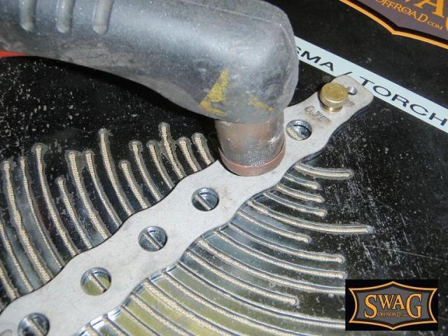

Plasma Circle Cutter
plasma circle cutter

Plasma cutting sheet metal
A plasma cutter is a very useful tool.
It cant take the place of a sheet metal shear but it can come pretty close.
For cutting sheet metal with a plasma cutter, less than 40 amps is needed and at that amperage, the torch tip can be rested directly on the metal being cut which allows for dragging the torch against a straight edge.
The idea is simple. Figure out the dimension between the center of the torch and the edge, and clamp a straight edge that distance off where the cut should be made.
Its easy once you figure out the optimum amperage setting, travel speed, etc.
Plasma cuts are cleaner than oxyfuel cuts on sheet metal and it doesnt even matter what kind of metal you are cutting.
Of course, the dross needs to be ground off before welding, but that only takes a few minutes.
