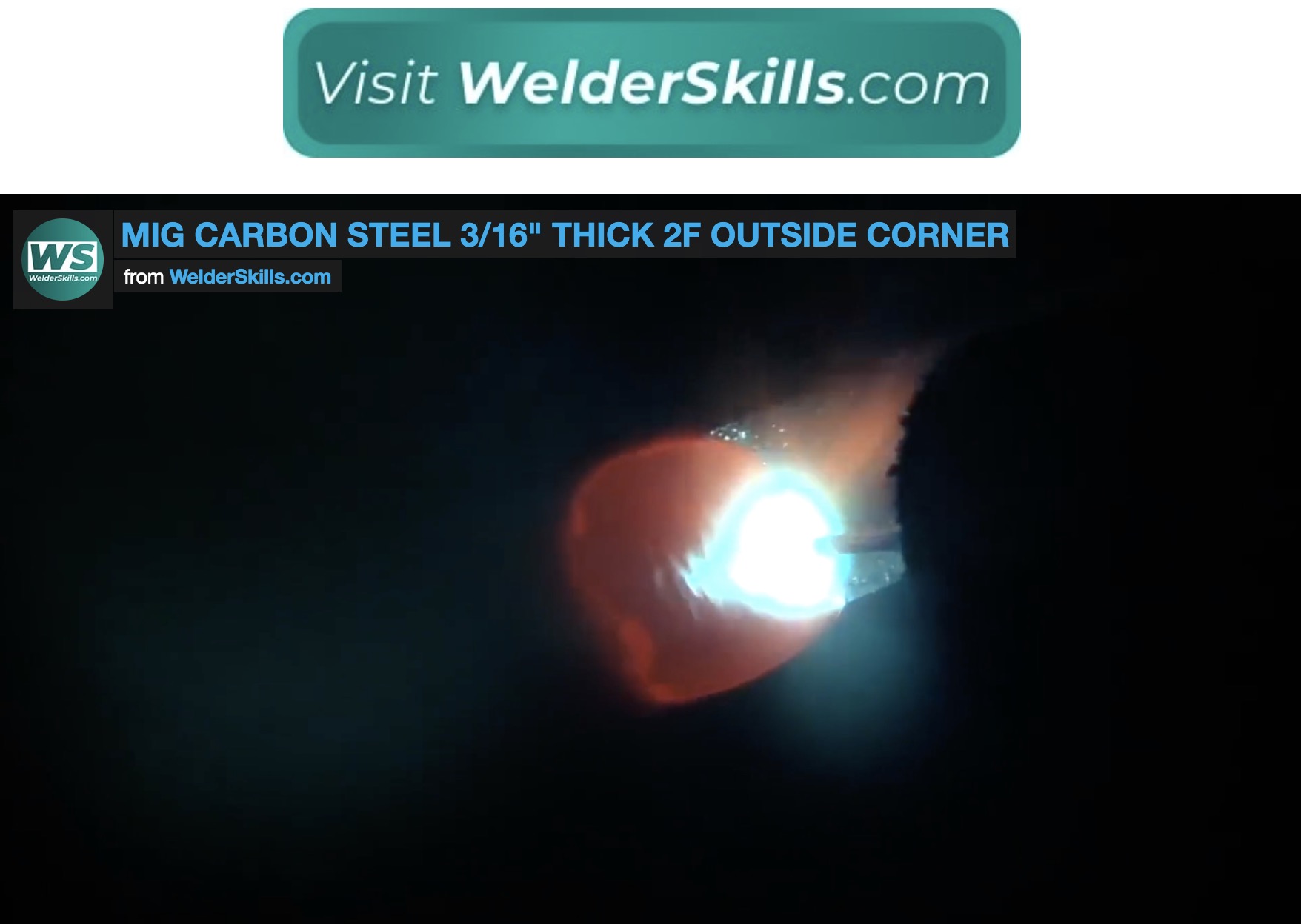

MIG CARBON STEEL 3/16" THICK 2F OUTSIDE CORNER

WELD PROCESS = GMAW, SHORT CIRCUIT MIG, GAS METAL ARC, BARE WIRE MIG
METAL TYPE = CARBON STEEL, COLD ROLLED STEEL, AISI 1010
THICKNESS = 3/16"
WELD TYPE = Fillet weld
JOINT TYPE =corner
POSITION = 2F, horizontal
VOLTS = 18.6 volts
WIRE SPEED = 190 IPM
WIRE SIZE = .035"
POLARITY = DCEP
GAS FLOW = 20-25 CFH C25 GAS
CTWD  = 3/8”-1/2"
FILLER METAL = ER70S6
ADDITIONAL SETTINGS =
 TIPS:A relatively short stickout aka contact to work distance CTWD of 3/8” to 1/2" makes a big difference.
There is a wide range of settings that will work on outside corner joints depending on the desired outcome and customer requirements.
Lower wire speed settings slow the travel speed and can achieve a certain desired appearance...but the main goal should always be to achieve a sound weld.
mig welding carbon steel 3/16"
