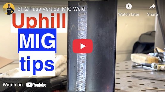

mig-180-primeweld-settings-techniques-2f-3f-thumb
115-volt-mig-1f-flat-corner-thumb
basics-3f-downhill-11ga-mig180-thumb
uphill-mig-tips-thumb
