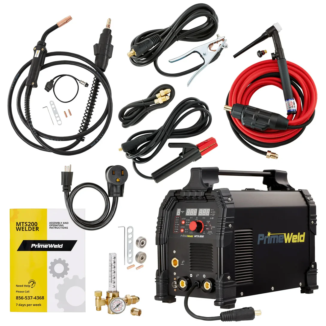

And since the welding machine I used was not just a mig welder but a MTS (MIG,TIG,STICK) welder that also does lift arc TIG and Stick welding, I also showed some Lift arc TIG and walking the cup technique.
An MTS (MIG,TIG,STICK) welder like the primeweld mts200 gives you a lot more options than a standard mig welder.
I use it primarily as a MIG welder but it sure is nice to have the option of stick and lift arc TIG.
I highly recommend the PrimeWeld MTS200 as opposed to a mig welder that strictly does MIG.
primeweldmts200-package
MIG Welding a 1/4" lap joint using a primeweld mts200
