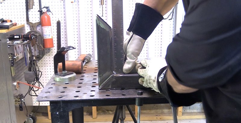

I got some 45 degree miter cut square tubing just for this video and what I want to demonstrate in this video is how weld metal shrinks and how you can use that to your advantage in keeping things square.
I tack welded things up using a tig welder and then mig welded them  outside the shop using a lincoln powermig 210mp using .025" er70s-6 wire.
I like to use this smaller diameter wire on small parts and thin metal because I get really crisp arc starts and a smooth arc.
But the main thing in mig welding square tubing is often just keeping things square and straight without distortion.
Bead placement and direction of travel can have a big impact on keeping something square.
Remember that direction of weld travel can influence how a part distorts because weld metal shrinks....and it shrinks in the direction of travel.
So I usually weld the outside corner first on a 45 degree miter cut because that weld typically will not pull or move much.
Next, I weld the 45 degree joints from inside to outside.
Lastly, I weld the fillet weld in the crotch of the joint.
By the time I have the first 3 welds done the joint is pretty much locked in position and wont move much.
But if it does move, it will pull inwards so you have to keep that in mind.
My settings for the 11ga square tubing were 20.5 volts and 345 ipm using .025" wire.
