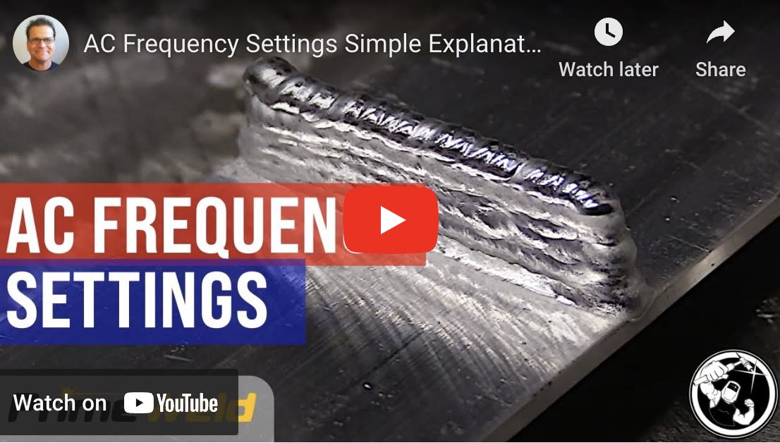

AC Frequency settings
Need to learn how to set AC frequency for different applications?
watch the video below
primweld225-ac-freq-yt-thumb
  • Process Setting: TIG
  • Polarity: AC (make sure the tig torch is plugged in to the correct dinse port)
  • Shielding gas: 100% Argon
  • AC balance: Enough cleaning to get a shiny clean puddle
  • AC frequency: Higher for tighter control, lower for wider arc and more heat input on thick aluminum.
Rule of thumb:
Know your Settings but More knobs don’t always mean better welds.
AC frequency is a "nice to have" feature but sound welding technique makes more difference than AC freq.

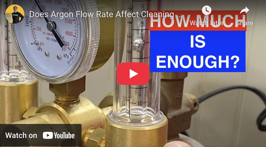

Cup, Gas Lens & Gas Flow
argon-flow-thumb
weldmonger-dual-flowmeter
  • Use size 4 thru 8 cups - A Gas lens helps especially with a longer stick out.
  • Moderate gas flow (avoid turbulence) 2-3 CFH per cup size
  • Adequate stickout without losing coverage
Rule of thumb:
If the aluminum metal is clean and the aluminum puddle still looks dirty, think gas first. then ac balance settings.

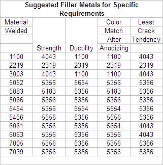

Filler Rod Selection & Technique
basic-tig-filler-selection-thumb
TIG welding filler metal is in stock at Weldmonger.com
aluminum filler metal chart
  • Common fillers: 4043 (smoother) or 5356 (stronger)
  • Use smaller diameter for thinner metal
  • Keep hot tip of filler inside shielding gas
  • Add filler early
Rules of thumb:
  • Filler rod diameter not bigger than thickness welded (usually).
  • Larger diameter filler rod is easier to feed but chills puddle more

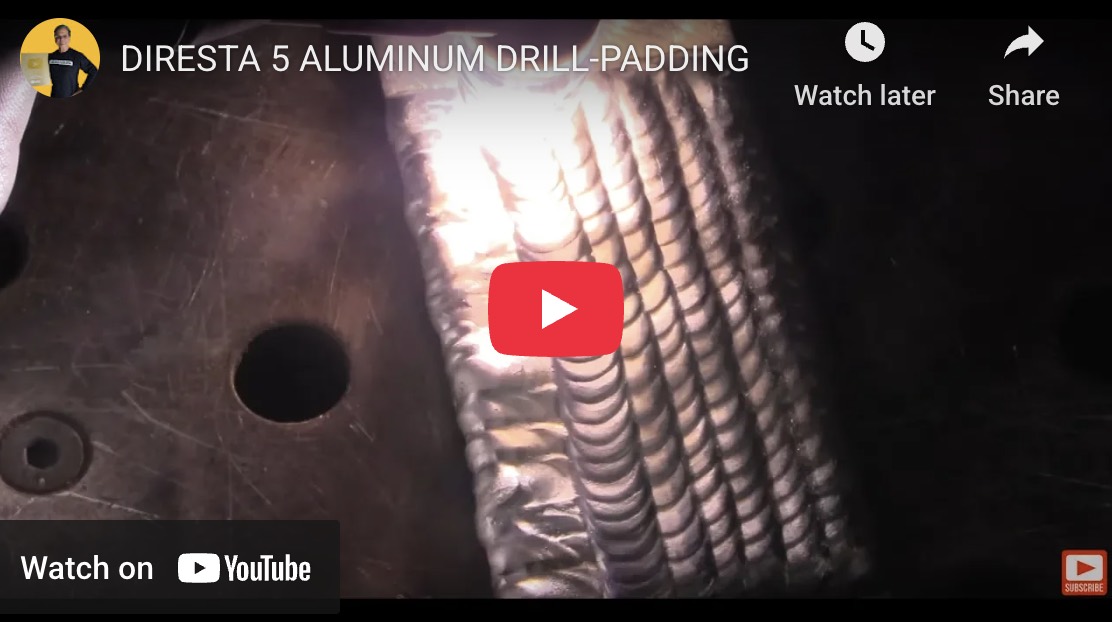

Practice Drills (Do These First)
diresta-aluminum-drill-thumb
better-way-tig-weld-thumb
Practice stacking and padding beads on plate before doing weld joints.
