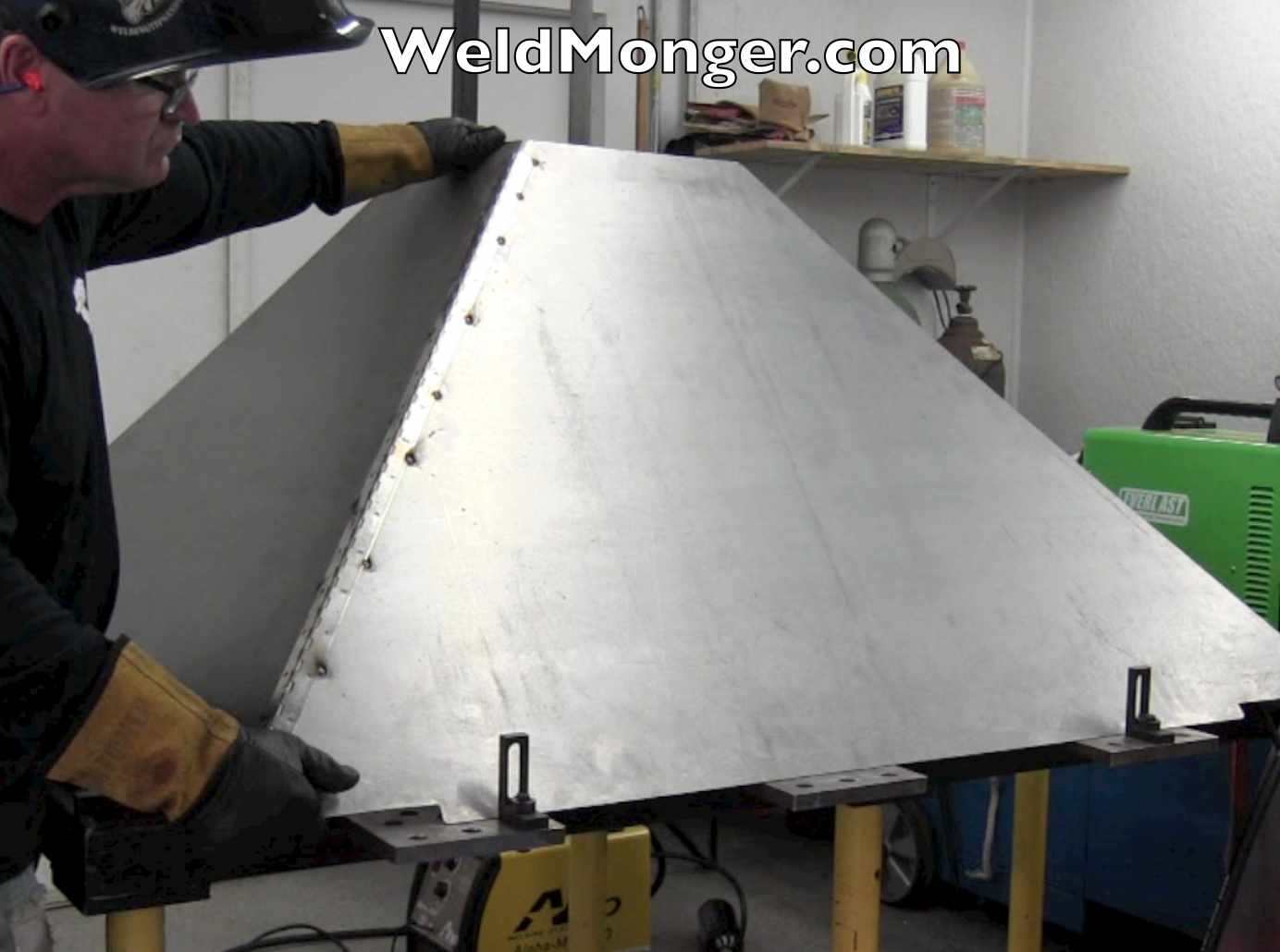

The PlasmaCam is set up and I am fabricating a downdraft chute for it so that I dont mess up the nice clean speckled epoxy floor in my friends building.
My plan is to make a flange that accepts a 8" utility blower along with  some flex hose attached to the blower to exhaust fumes outside.
I am fabricating this downdraft chute out of 18 ga cold rolled steel and my plan was to skip weld the whole thing out using 2 inch welds on 2"centers.
Then I got to thinking about just how bulky and hard to handle the chute would be once it was welded together.
So I bought some piano hinge at Home Depot and decided to try to fabricate the chute in 2 pieces.
If I ever need to move the Plasmacam, it will be pretty easy to cut tack welds loose and then fold the chute up.

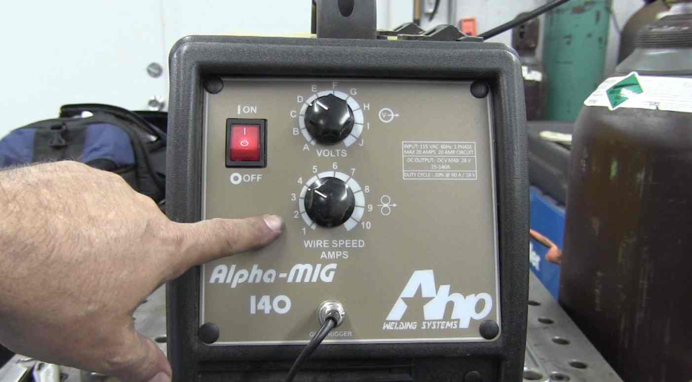

115 volt mig welder comparison
For the welding demonstration in this video, I used an Everlast imig 140e
along with an AHP alpha-mig 140.
the Everlast 140 imig is an inverter style mig welder while the AHP is a transformer style mig welder.
There are differences in the arc as well as the capability of these 2 machines.
Watch the video and see the differences between inverter and transformer mig welders.
biggest difference is the Everlast inverter had power to spare.
