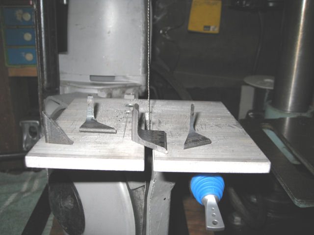

Finished saw ready for toggle switch to replace the trigger switch.

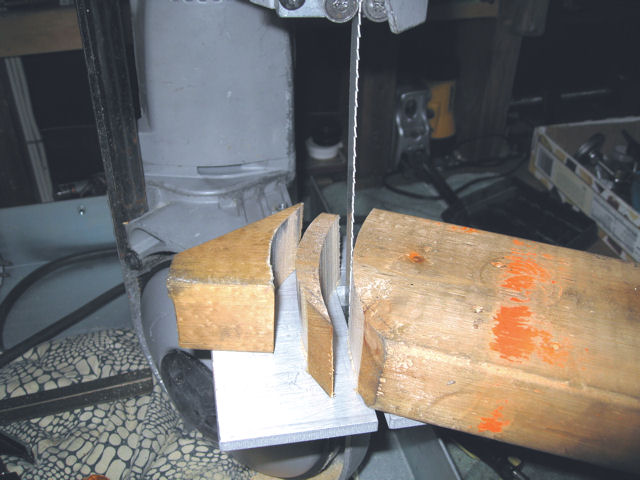

Surprisingly it can cut a pretty tight radius in wood (It is actually a metal saw) with ease. And it cuts effortlessly. The blade speed is actually pretty slow compared to a table band saw which is great because it doesn't tend to grab things from you and throw them.

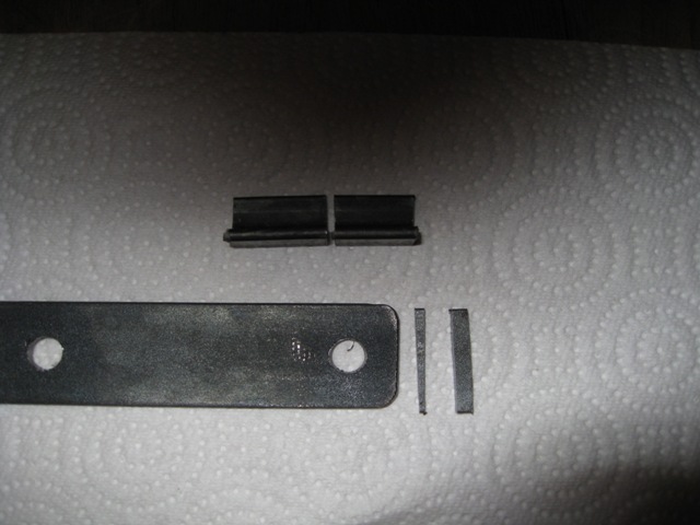

Since it is actually designed for metal, this is the best part. We all know how much a hacksaw takes out of you just cutting a couple of pieces and this cuts super accurately and is controllable with ease. note the sliver piece of metal it cut off this band iron.
Tiny cuts and accuracy are great! I even cut up a 2" thick piece of foam rubber pad to make some things, I thought it would grab the rubber and try to pull it in the blade but it cut it perfect. Anyone practicing welding knows it is a pain to cut like 4" sections of band iron into plates to practice with, seriously, this thing just cut each piece of 1" band iron in approximately 4 seconds each . Sure beats a hack saw!
