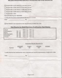

Please review and comment on PQR. Having trouble with under bead.
reply,
limit the depth on the support bar to about half what you have listed.
It was hard for me to see, but it looked like .100
if you use a depth of .050" that should limit melt through
