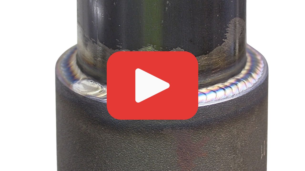

What Is Pulse TIG Welding?
Pulse TIG involves alternating the amperage between a high “peak” current and a low “background” current at a set frequency. This creates a pulsing arc that controls heat input without sacrificing penetration.
  • Peak Amps: Provides penetration and fusion
  • Background Amps: Maintains the arc while allowing the weld puddle to cool
  • Frequency: How many pulses per second (Hz)

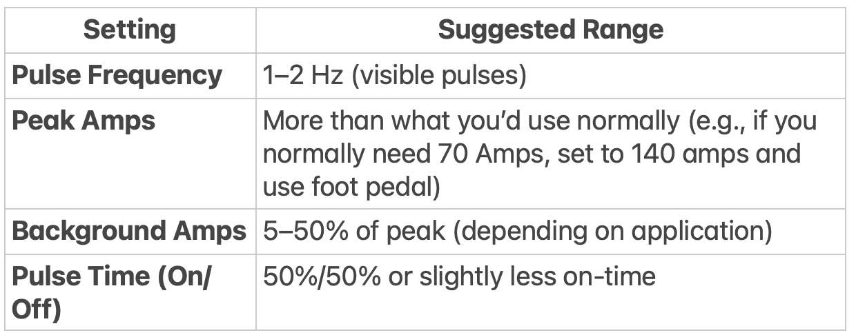

Basic Pulse TIG Settings
pulse-settings-stainless-chart
Example Setup:
  • Peak = 70 A
  • Background = 35 A
  • Frequency = 2 Hz
  • Balance = 50/50
This setting gives you a good rhythm to dab filler on each pulse, resulting in a clean, rhythmic bead.

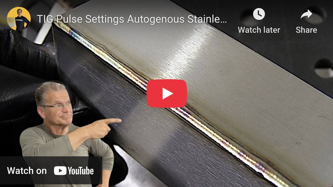

  • I like to use pulse rates of .7 to 2 pulses per second or higher than 33pps,  and pulse rates of 3-30 are jut hard on my eyeballs and annoying to watch.
  • A pulse setting of around 1-2pps , with low background current and low pulse width, when used in conjunction with chill bars can be very helpful on outside corner joints in limiting distortion.
  • High speed pulse rates of 33pps or more can be very helpful when welding on or near an edge.
  • Automated tig welding benefits more from pulse than with manual tig welding due to human adjustments
  • The rule of 33 is where you set all pulse settings to 33. 33 pps is not difficult to watch and can help to agitate the puddle and move it along at lower overall amperage. The rule of 33 for pulse settings also helps for filling gaps
