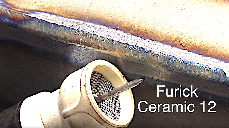

But you don't have to measure temperature or dimensions to notice some of the benefits of high speed pulse tig welding.…Welding near an edge will show you the benefits quickly.
Here are some settings I use for welding near an edge.
* Amperage set to roughly twice what I would set it to without using pulse (remember, you get an average of the high and low pulse amperage settings and your output will be less with pulse)
* I like pulse frequency set to 39 (I like that number because it's easy to remember)
* % on time also called pulse ratio set to about 30
* Background current set to about 30
I found these setting to work great for welding near an edge, for filling a hole in sheet metal, or for weld build up of a thin edge.
Changing the pulse frequency to 1 pps and leaving the other settings alone let me lay a nice stack of dimes bead on thick stainless whether I left the rod in the puddle or dipped on the high pulse.
