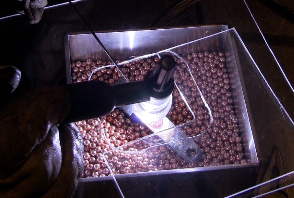

Have you ever seen a propane fire pit full of polished stones?
I am trying to use this idea , for a "proof of concept" idea. using some type of media as additional diffuser in a small argon purge box.

Tig welding a small part in a small argon box full of BBs.
tig-welding-small-parts-argon-box

Now that I have proven the concept, I will experiment with other media.
maybe copper balls, stainless steel balls, glass beads, polished rocks, etc.
I think copper balls is going to be the best bet but I am having a hard time finding the right size.

Use caution if you decide to give this a try
BBs are made of carbon steel and are copper coated.
There is a definite risk of contaminating stainless steel parts and there is also a real risk of melting BBs to the part being welded in this small purge box.
That is why I am going to try other materials...
