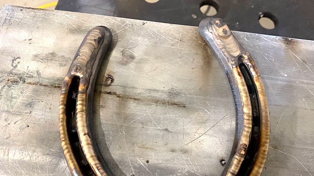

For some reason, I thought about the old saying about a "gold  horseshoe" and I had this idea for overlaying or cladding a horseshoe with silicon bronze TIG rod and then shining it up to make it look like it was gold plated.

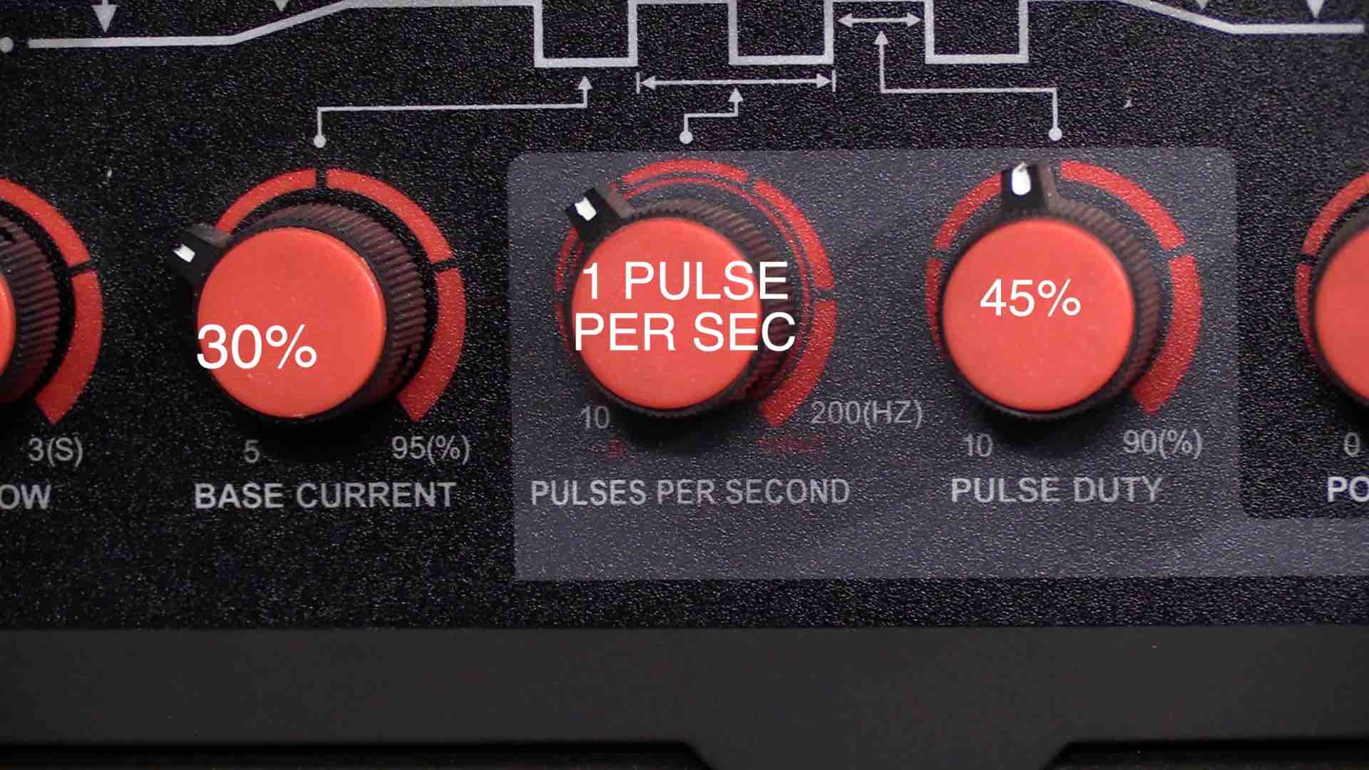

Pulse Settings for Overlay with silicon bronze TIG rod
pulse-settings-silicon-bronze
You don't really need pulse to use silicon bronze TIG rod  but I have found some pulse settings that seem to work really well for me for tig brazing with silicon bronze
